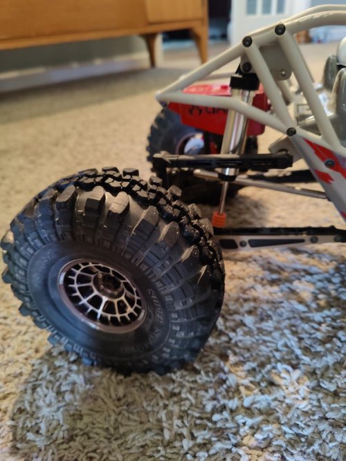

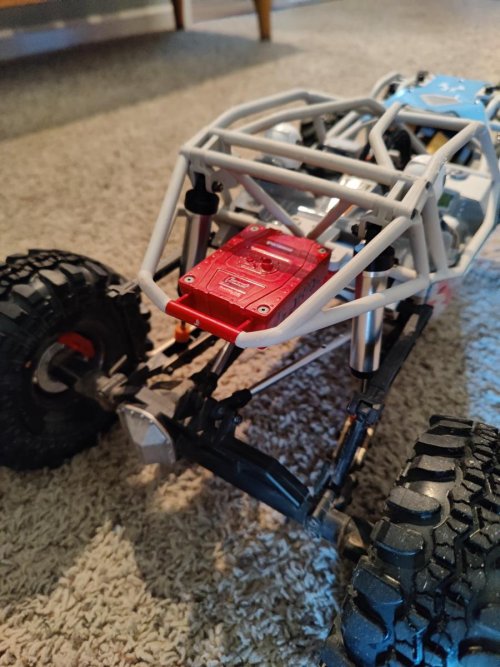

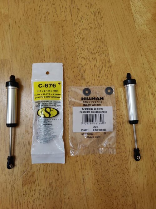

So after trying to fit some misc springs, oil weights, not really achieving what I was looking for. I really wanted an internal spring set up, and after scouring the interwebs, nothing really fell into the size range that I felt was good quality. Reading Panthers thread, got me to thinking about the UDR set up and the non threaded second shock they use. The front shocks are 134 mm, bingo! Ordered up a set of front shocks from Jenny's, and started tinkering with the non threaded shocks to make them internal sprung. Found some 7/16 x 2 1/8 compression springs with .032 wire that fit perfectly inside and fairly soft spring rate. Had to fiddle a bit with o rings to eliminate the bladder, and came up with a 5/8 x 1/16, and a 1/2" grommet with a 5/16" shoulder that the spring fits snuggly over to keep it in place. Settled on 50 wt oil.
Outcome? Lower ride height by 10 mm, and about 10 mm of sag. Of course I had to modify front shocks to match ride height, so basically did a pen spring mod with some RC4WD springs to pull front end down. Cut down tremendously on torque twist, corners way better without flipping over, and pretty much all the "bounce" has gone away. I am going to call this a major win!
Did some measuring on the front end, and just ordered up a set of non threaded front UDR shock bodies to do the front, along with some GTR 47mm shafts. This combo should give me the same length as the modified fronts now. I will update if it is as much a success as the rear end turned out to be.

Received the front shock parts and got them together. Used same spring as in the rear shock, same o ring and grommet, and filled it with 20 weight oil. What a difference in handling with this set up!
Stock shock lengths:
Front- 127mm
Rear-145mm
Traxxas UDR set up:
Front- 110 mm
Rear- 135mm
Yes, travel is reduced, but is that much stock travel really needed? This UDR shock set up lowers rig by 10 mm, and allows for about 8 ish mm of sag. The lower cg makes for much better cornering. From a dead stop and punching the throttle, the front end stays a lot more planted without all the lifting and torque twist. Definitely a handling win for the Ryft! Also a much stronger shock.
I used the parts from the threaded shocks that came with the set for the fronts (top and bottom caps, piston and rod ends). I also used 3mm washers and nylon spacers to take up the slack from the narrower width ball ends. The rear parts are listed above, and the additional Traxxas front parts ordered were:
UDR non Threaded shock bodies #8453
GTR 47mm shock shafts #5463T
Hope this might help other that are looking for options. "thumbsup"
