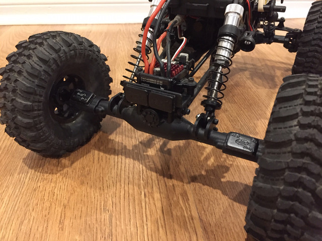

I recently got a nice deal on a Night Crawler SE, and have been putting her through her paces. It's not too bad all stock. Major issue being the high center of gravity, but other than that it's a decent crawler.
Here are the changes I've done so far:
- Generic 25kg waterproof servo
- Duratrax deep woods 1.9 pre-mount. *The pre-mounts seem to work well with the light weight of the Night Crawler. Duratrax C3 pre-mounted wheels are super soft, and the side walls tend to crumple under heavier trucks. They do fine with the NC.
- Swapped out the receiver for a spektrum SR210 to use with my DX5 rugged.
- Removed all the scale accessories from the chassis.
- Ordered some adhesive weights to add on the front axle.
Next round of mods.
- 189g of adhesive steel weights around the chassis to lower the CG. Mostly on the front and around the servo.
- 20mm wheel extenders to widen the footprint.
- Tossed on a losi mini-8 buggy shell for laughs. Then it grew on me, so I'm planning to see how it goes. :mrgreen:

Thanks! I've been enjoying this crawler a lot recently. It brings back the nostalgia of driving my old venom creeper, except the NC is a lot more capable.
On another note, I decided to go down the "monster truck" route with this one with 2.2 bully tires and an old redcat E10 body. * The E10 body is convenient because the pre-drilled holes line right up with the NC body mounts.
I'm pleasantly surprised with the way it crawls & looks now.
