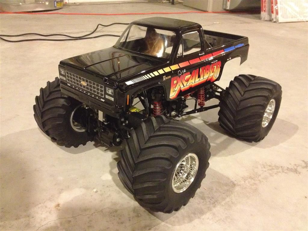

All stock. Just added Clodbuster tires with CPE adapters and a Chevy body. It runs great and is pretty fun. The torque twist is horrible though. I am considering a full conversion to CPE monster chassis with anti-sway bars. I wish Axial would come out with a full blown monster though, all the parts are there.

A lot of us use ground pounder twin plates, or like myself, I went with CPE's Barbarian chassis. Build specifically for our drivetrains. And the sways are super efficient!

That's cool Bigstu. How'd you do those Excaliber graphics? I was thinking of doing the earlier gray Excaliber! I will definitely post over there when my Barbarian gets installed.
mirror the tranny should help with torque twist. also hows that stock servo holding up? mine died with i put sickier tires on let alone bigger. lol. looks sweet tho. would be cool to see on a scale chassis like scx chassis or check out the tcs x trail chassis. looks good tho.
So far the servo working. I stripped out the servo arm though and put back a traxxas servo saver but it's too weak for those big tires. Looking for options.
I first tried my scx chassis but can't get the body high enough or suspension tall enough to clear the tires and it's too much trouble to lower the trans.

Like mentioned above, mirror the trans to help reduce torque twist, also a little stiffer spring in the rear helps.

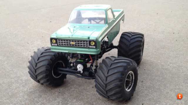

I did an AX10 Monster conversion a few years back.
Ended up making it my "homage" to Bigfoot #5 by giving it some old Jumbo Kong Tires.
