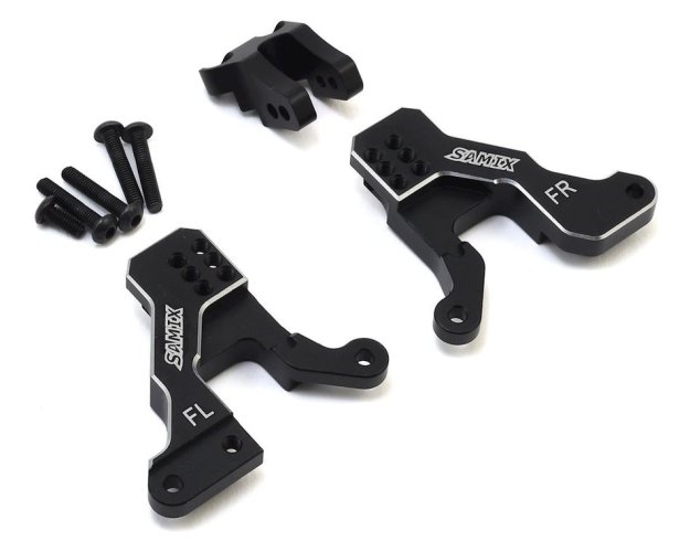

I had to just purchase front shock towers for both front and rear Samix makes great front Panhard and you just reverse in the rear as well as the servo as the servo mount replaces the rear brace!!!

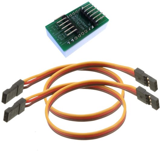

Now for radio The Traxxas TQi can be programmed to do a lot of hacks but for the 4WS its only going to be able to work with a 4WS Kit like the Bastens QuadSteer 4 Wheel Steering Control Module Works with Either 2Ch or 3Ch transmitters and the yes a Futaba 7PX or 7PV would be great with seven channels but all you need is the flysky GT5 6 channel Radio which has the 4 steering modes available now the Honey Crawler TRX4 project i have a thread on here I use (channel 1 steering) (channel 2 throttle) (channel 3 trans hi/lo shifter) (channel 4 Accessory on/off switch for lights or whatever) (channel 5 front diff lock) (channel 6 Rear diff lock). this works amazing and flawless!!!!

I have that Bastens QuadSteer 4 Wheel Steering Control Module but couldn’t get it to work like it would like it to work. I would like to have a self centering steering switch for the rear steer. Keep us posted on your build.
BUZZZZ..... WILL DO FOR SURE!! Yeah the Bastens is still limiting now as fa as centering the Flysky GT5 will center the 2 servos in Crawl mode and the servos im using on the build will be the reefs 500 which I can program to center with the reefs usb link!! another hack is using your quad steer first center the front servo then unplug it and plug the rear and center that I heard that can work???

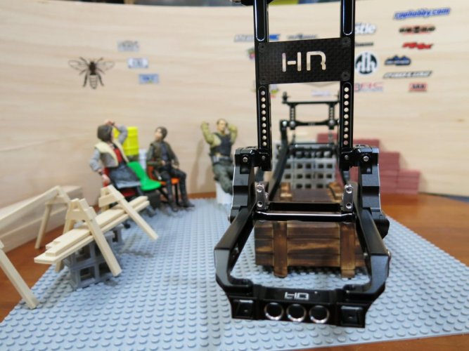

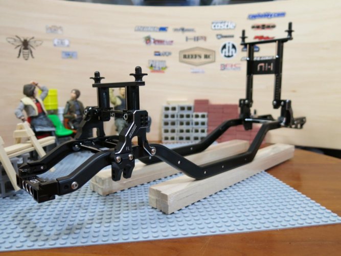

Re: Rear steer (Honey 4WS Comp Crawler)
here is the base of the chassis I always set up a base project to get ideas and this build will start soon the high body post is on the rear as an accessory maybe as this like all my rigs I keep half cab no rear bed Yet!! BUZZZZ.....
