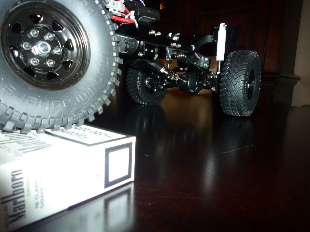

boy is this thing stiff.. wow ;-(
Any tips and thoughts, upgrade suggestions regarding the stock shock setup would be greatly appreciated..
Thanks ;-)
Remove the springs from those shocks, measure the length of them, then throw them in the trash. Go to a hardware store that has a good selection of compression/extension springs. Find some softer springs that will fit in your stock shock bodies. They're usually dirt cheap and I've almost always had good luck with finding super-flexy internal or external crawler springs that way (at least at hardware stores here in the US). Or you could just buy a better set of shocks... Hope that helps, and get that thing done!

Actually the problem on the old RC4WD white shocks was not the springs themselves but the entire housing and o rings. I took the springs out and ran the shocks up and down and it was stiff as hell even without the springs, not to mention a little leaky too.
