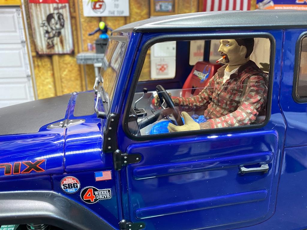

I’ve done many bodies using this technique. It holds up great and if it does get scratched, it’s easy to touch up.
And yes, use the film on outside as a mask. Gently and lightly using a new blade, cut the film. Once film is peeled, lightly press down on remaining film. You should get a bleed free edge every time.
Here is a pic of my PRO and Phoenix. All the black is painted on the outside with the PS-55 Flat Clear to seal and protect.
B-MOW71, you are precisely the inspiration I was referring to "thumbsup"
I'll be using the same bright gun metal as you as well. You did a phenomenal job man!
