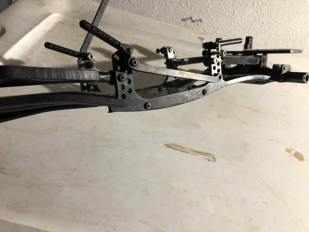

1 of them is pretty well sorted albeit running older Novak electronics. It’ll do for now. The second on is more of a challenge. It also has a package of older Novak electronics on it but it’s built on what looks to be a 1 off chassis of sorts. The setup doesn’t utilize shocks at all. The kicker is there is a crack in the chassis so it’s worthless and sourcing another seems to be a dead end.

Pics of the chassis

that chassis is a SSS, it was/is made by billet works. you can get a whole new one or possibly get replacement parts.
imho. build with what you have, maybe try a different chassis and go from there. this hobby/sport is all about learning and trying things.
I’m all for that but not very well versed in crawlers at all. Now that the chassis has been identified I’ll try to get one since that’s the easiest route. Thank you !!
I’m not sure it’s from billet world since it looks like everything they make is aluminum and this is Delrin I believe. Sent them a msg anyways to check.

I’m honestly stuck with what direction to go with this pile of parts. Can I just use any chassis and swap the arms over ? Then add the electronics and pick a pair of shocks ? I guess what I’m struggling with the most is if these electronics will mount to a specific chassis, or I use the skid and get new rails. Then will the arms be long enough or do I need new ones as well.

I would chop the rest of the torsion bars off the bottom of the chassis and run it with some short shocks (75mm or less I would bet fit just right). The triple S was pretty novel at the time, but torsion chassis can be hard to set up and it's already damaged. Should still perform well and have a nice low CoG, Billet works could probably cut some new side plates out if you want to stick to torsion. Electronics should work just fine, that was the go-to setup back in the day. A new $300 RTR isn't going to come even close to a stock losi.
