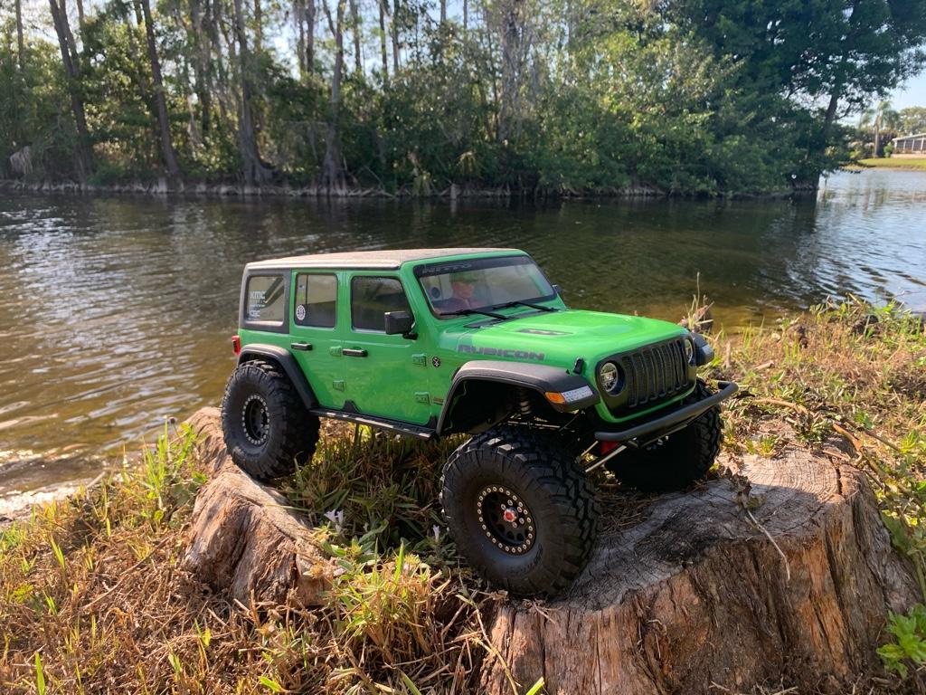

I recently painted my nephews Jk...
I painted the black, for the top inside, and outside the body. The lexan paint tends to be fairly flat so it works out good. I used the overspray film for a mask and that worked better than I imagined it would.

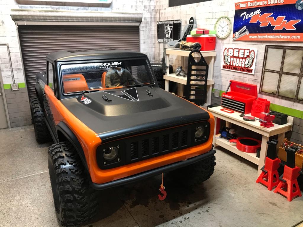

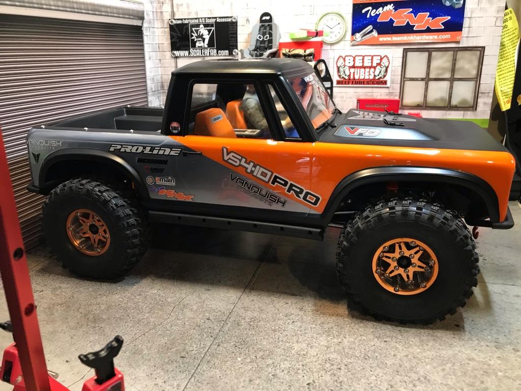

For the black matte finish on the outside, I use a couple coats of Tamiya Black #PS-5 painted on the outside. I then use a couple coats of Tamiya Flat Clear #PS-55 on top of the black. I use the outside film as a mask. The flat clear will help protect the black from getting scratched. I use this method on all of my rigs and have had great success.
Here is an example on my PRO
