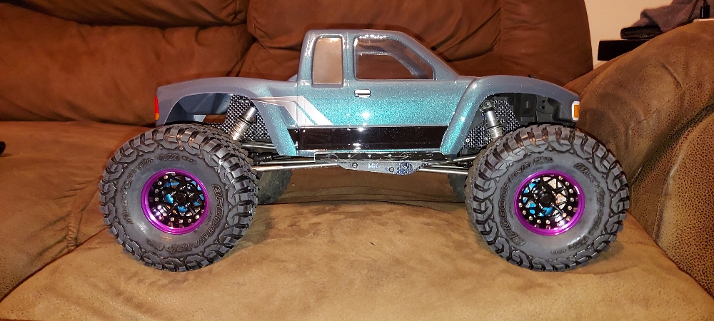

I use the ps flat clear as a base, then use watever brand of paint tickles my fancy. The reason i do it is that the ps sticks to the lexan better than lets say rustoleum. So the clear just gives the rustoleum something to cling onto. I done that with my basher bodies when i got into rc in 2017, just carried it over to the crawler side.
This is with ps flat clear first, then rustoleum colorshift, backed with rustoleum dark grey.
The flat clear really does make the flake pop
Yeah I forgot to mention the other reason was to use a non lexan specific paint afterwards. That cliffhanger body looks great!

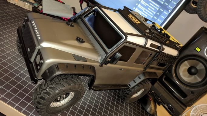

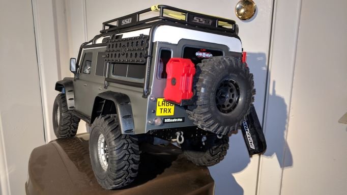

Not the greatest example, but factory silver TRX-4 Defender sprayed white on the roof, and then flat Tamiya PS clear over everything with the windows masked - I MUCH prefer my vehicles sprayed in matte clear, just looks more realistic & less toy-like:
I could live with the factory paint but it definitely looks better with the shine cut down a bit.

Love that body. Is it Proline Cliffhanger Body ?
Love also the wheels.
Are the rims Boomracing superbuild ?
These BF G are the best looking tyre ever made.
Great paint job "thumbsup"
Yes sir, it is the cliffhanger. The purple wheels are the probuilds, they actually went on my gshot rig. Bfg are ok, i prefer the hyrax in g8.
Thanks, i like how it turned out. That truck is the vanquish phoenix on a gspeed v3 blue cf chassis. A few months ago, it took a tumble off a 60 ft cliff... n survived! Matter of fact, i ran it 2 weekends ago at the same place it went off the cliff
