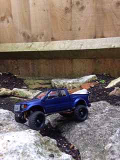

Here is a video of my Orlandoo hunter, it has the metal axles and dive shafts, mini z overland wheels and tyres fixed with custom cuts adaptors. Spektrum micro receiver, Banggood esc and sound unit, 300 rpm motor and a chassis mounted Turnigy TGY-1370A steering servo.
It's not finished yet as I'm redoing the bed as I went over the top with trimming the rear arches so rear lights aren't in either and I need to solder one of the headlight wires back on.
Anyway the video
http://youtu.be/3T30oahOQS4

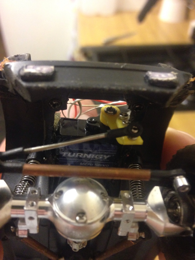

alsome orlandoo hunter . how do you mount a servo on the chassi my stock servo went out and want to try this what type of servo well fit.
Thank you, I simply dremeled out a hole in the front of the chassis and epoxied it into place, I'll post a picture later.
