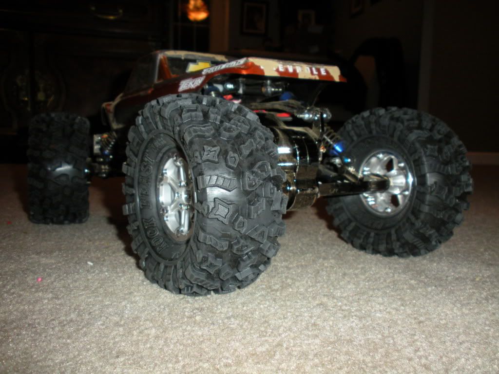

My Official Review of the PIT BULL "ROCK BEAST" 2.2 Prototype R/C Rock Crawling Tire.
Initial unmounted measurements,,,5.25x2.25...with out foams

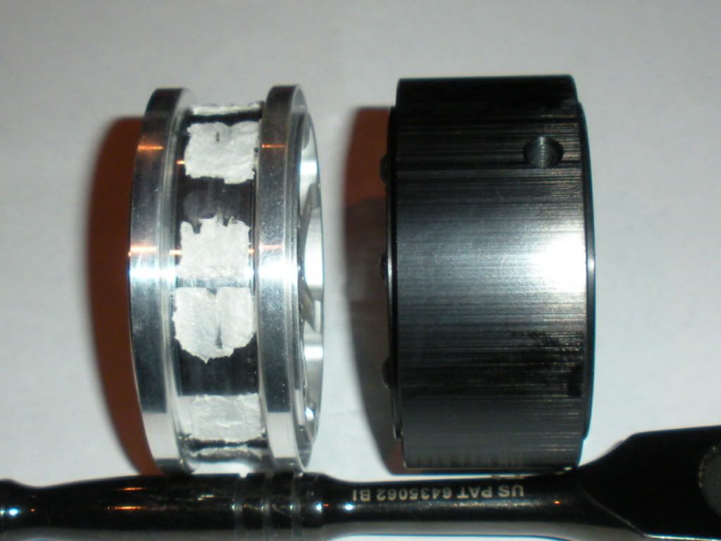

The start of my review...the rims that i will be mounting the rock beasts on, are made by a company called vanquish products,,the wheels are top notch and of the highest quality,with that being said i new they would be a perfect test wheel to see how well the rock beasts would mount up..the front wheels that you will see in the pics i have included are 1.2 inchs wide,,the rears are .7 wide,,the narrower of the 2 would be the challenge,,if any..
Ive also included unmounted pics of the rock beasts with leading competitors tires from left to right...x-locs from rc4wd,,rock grabbers from hpi,,sedonas from hot bodies,,pitbull rock beasts,,and the rovers from hot bodies...i just wanted to show the size comparisons between them all...

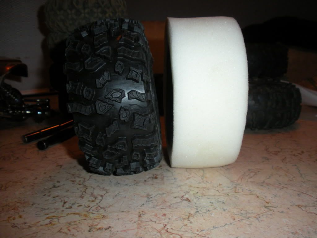

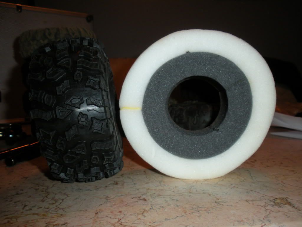

the foams i am using during the tests are from my sponsor Crawler Innovations ,,the foams are called the Double Duece's..they are a 2 stage non-memory foam with a stiffer inner ring and a softer outer ring,,the foam measures 5.5 inches tall and 2.25 wide..these foams are hands down,,in my opinion the best on the market today,,i run them in all my comp tires....

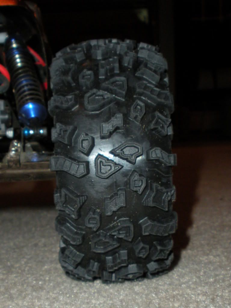

my general opinion on the ROCK BEASTS,,upon arrival i was like a kid on christmas morning,,couldnt wait to tear open the package,,after opening the box i was greatly surprised as to how much they are dead on to the 1.1 version of the rocker,,(i know because ive had em for the last 4.5 years,,lol)...i couldnt keep my hands off of them,,they feel amazing,,sticky,,very sticky,,the compound of the rubber will be a contendor ,,,the lugs are spaced enough to clean out well if they get dirty,,but not to far to weaken the integrity of the tire,,the spacing will also provide ample contact patch for forward bite,,and controlable side hilling...the ribbing in the side wall i feel was the right height,,thickness and amount,,some companies have to much which hurts the tire more than it helps,,i feel the amount the rock beasts have will be perfect,,,the lugs on the tires have good amount of voids which will help with gripping in all sorts of terrain,,,im glad PIT BULL decided to go with the staged side lugs instead of keeping them all voided lugs like the ones on there origonal prototype..over all im very pleased with the rock beasts...rating (based on initial contact with tire ,,,) A+....

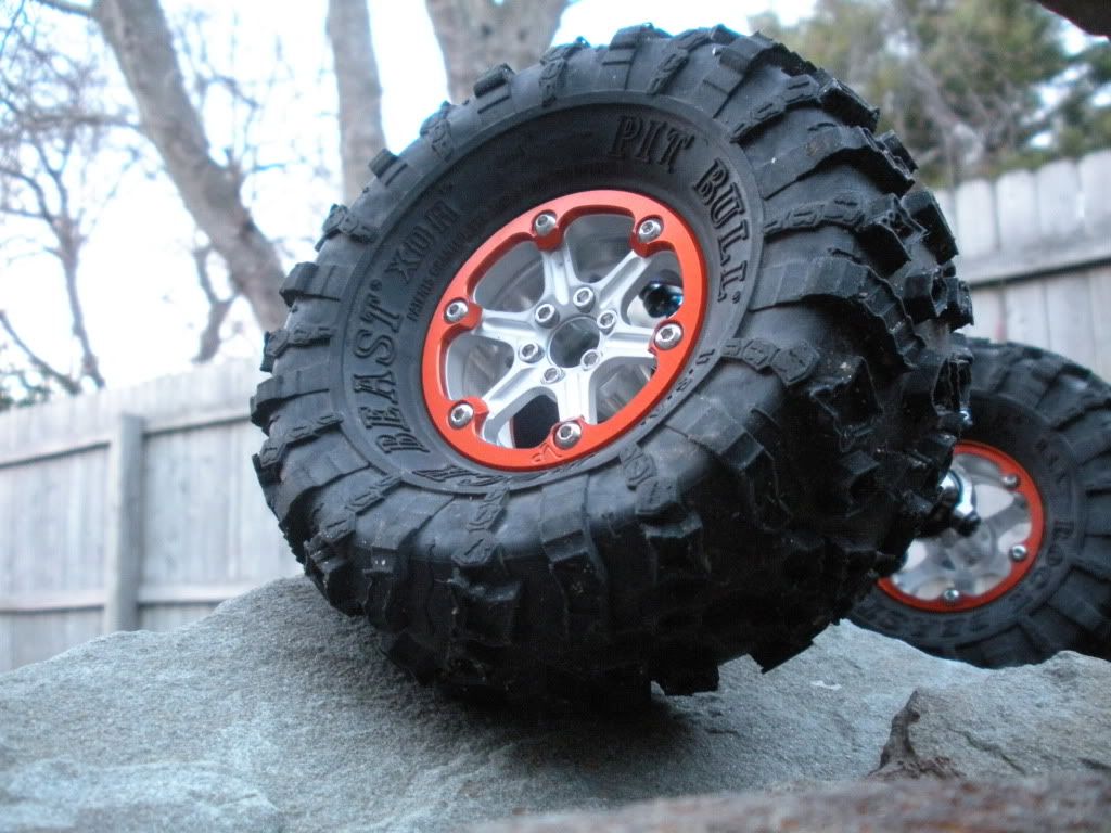

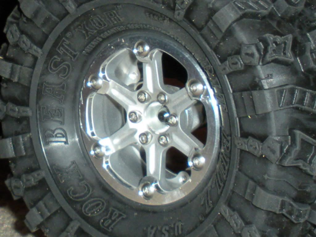

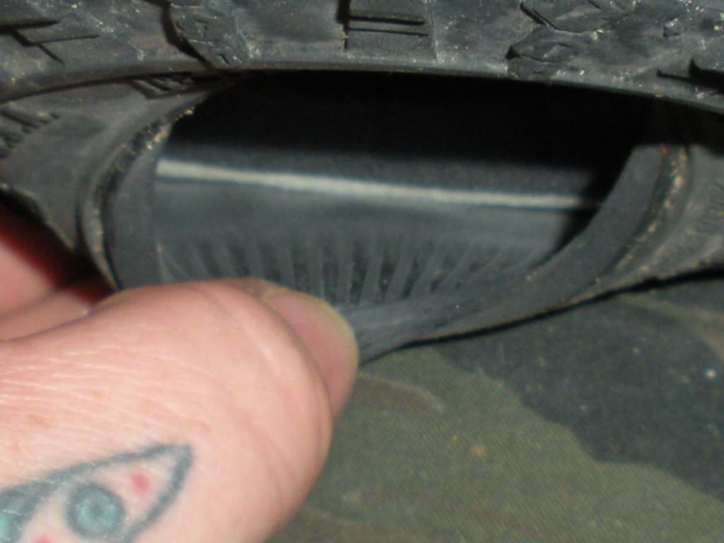

part 1 - mounting the tire on the wider wheel...with the over all width of the rock beasts being 2.25 i was not concerned with them mounting up on a wheel just a little wider than 1 inch,,and as expected they mounted up with out any issues,,the bead of the rock beasts are the perfect size ,,they gave me no struggle,,and did not resist being paired up with the wider wheels....
onto the rear (narrower wheel,,.7),,with the rear wheels being as narrow as the are i was a little nervouse about how they would pair up with the rock beasts ,,,and to my surprise they mounted up flawless..again no issues..
i feel that the bead size and carcass of the tire make mounting the rock beasts one of the easiest tire ive ever had to mount...rating = A+
after getting the tires mounted ,, i re-measured the over all size,,the tires height increased by .2 inchs giving them almost 5.5 inchs ,,the width was narrowed by about .3 inchs in the rear and pretty much stayed the same up front..
all of what im telling you will vary from customer to customer,,depending on wheels,foam inserts and rigs..

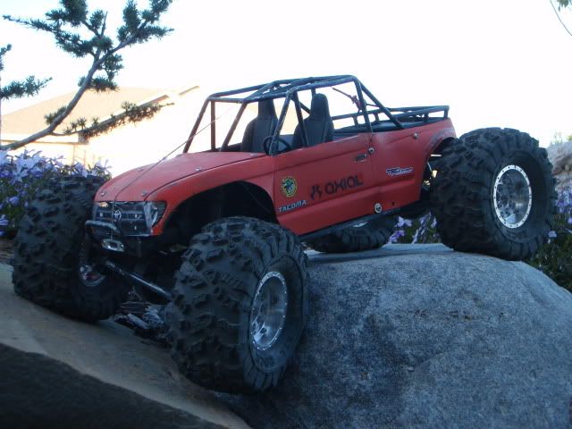

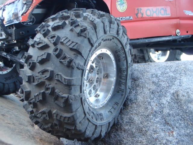

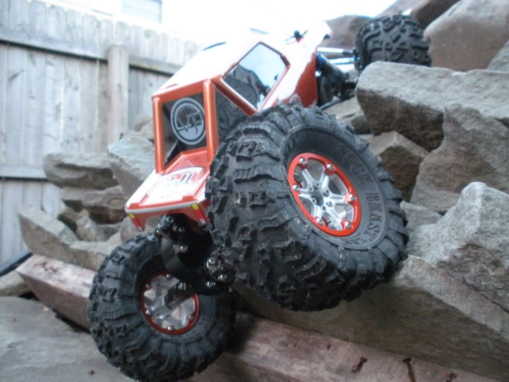

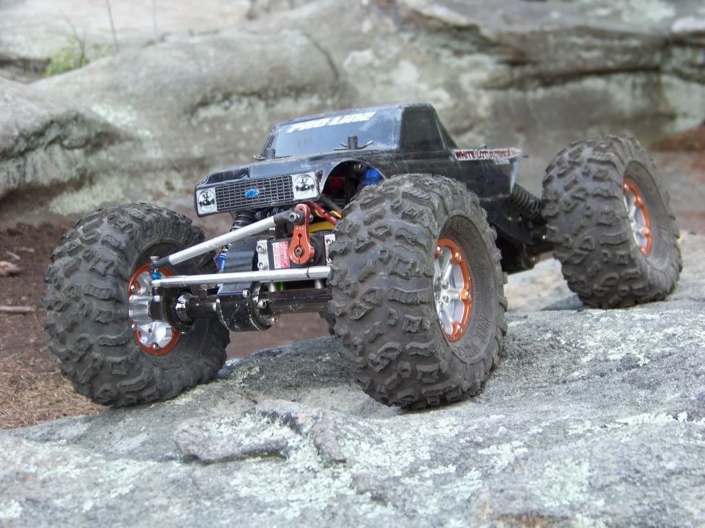

ok,onto the rocks,,.my home course has many different styles of rock from,,field slate,(medium to high traction),delaware river rock,(slick ,low traction),feather stone,,(high traction)and some pennsylvania mountain rocks,,(slicker than deer guts on a door knob),so i have a broad spectrum of different surfaces for a solid test...

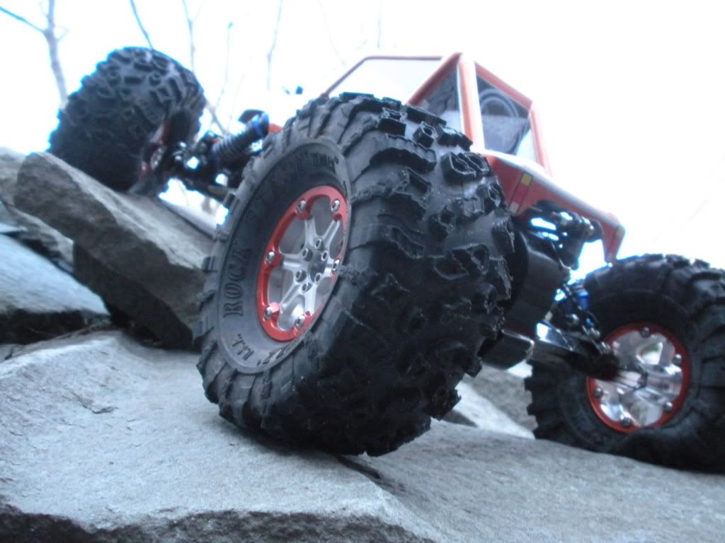

when i first hit the rocks i was just takin it easy to get a feel for the tires so i ran old lines that ive mastered with my rig,,and with no surprise they did eveything i wanted them to,,point and shoot for the most part,,they were very predictable,,so after i had warmed up to them i started to see what else they were capable of,,at this point it had started to rain so i was eager to see how they handle the wet,,my home course has a 48 degree vert thats about 5 ft tall thats very unpredictable because of the few types of traction...i went straight for it there are a few lines i know i have made before with other rigs so i made my choice on which line i wanted and started my climb...in certain sections i needed a little more wheel speed than in others,,but not full bore wheel speed...and still the tires were very predictable,,they held the lines i chose,,at the height of the climb was when i felt the weight issues from my rig,(any one who has run bullys knows they are pigs,,definately had to shave some weight off),,but that had nothing to do with the tires,,i was very impressed as to how well they held the brake,,when i let off the throttle they pretty much stayed where the rig had stopped,,
(on the 48 degree vert)i was not how ever able to get over the lip of the tall vert because of the weight issue,,after my new light weight cases arrived,and my new slw wheels for the front,,(shaved 17oz off the rigs total running weight) i went back at that vert and killed it...
down hill with a drag brake,,was a blast,,these tires held and controlled the descending lines i chose with out any issues,,off camber and straight,,
forward bite was very strong ,,and even stronger with a front dig,,the tires would wad up with how hard they would bite down,,when the dig was released the truck would lunge up the vert like a rocket,,,and again very predictable,,
so far my testing has been very pleasing and promising,,,

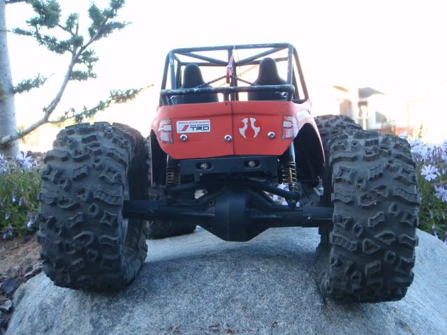

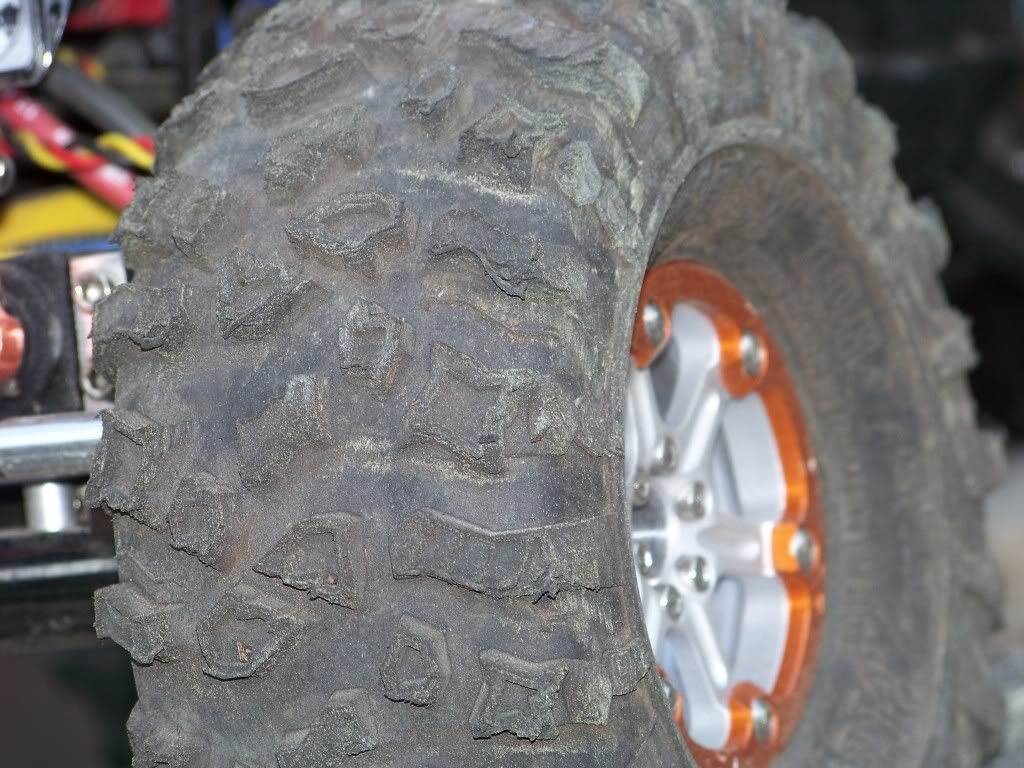

awesome zach,,no sweat on thread jacking,,add all you want,,i agree 100% on the more they get used the harder they hook,,and they work awesome in the wet,,,,,these pics were from ecc on friday during testing,,from feb-april,,probably 20-30 packs on them at this point,,2 local comps and then the big dance of ecc,,,
