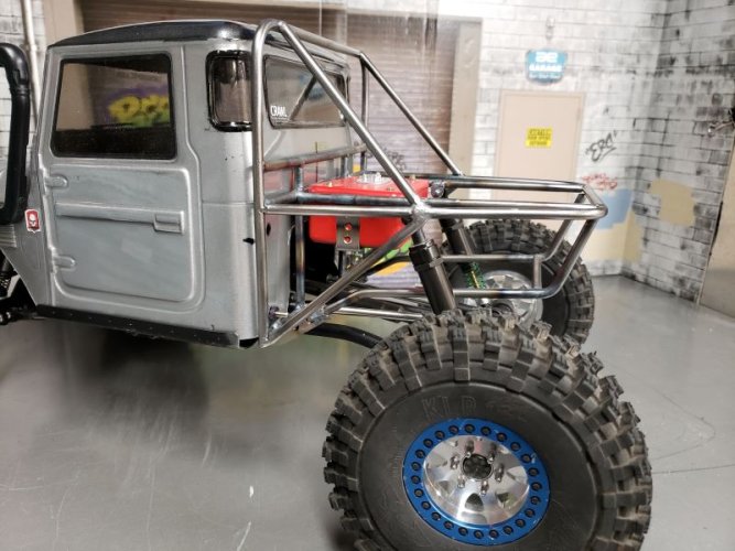

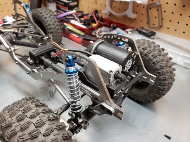

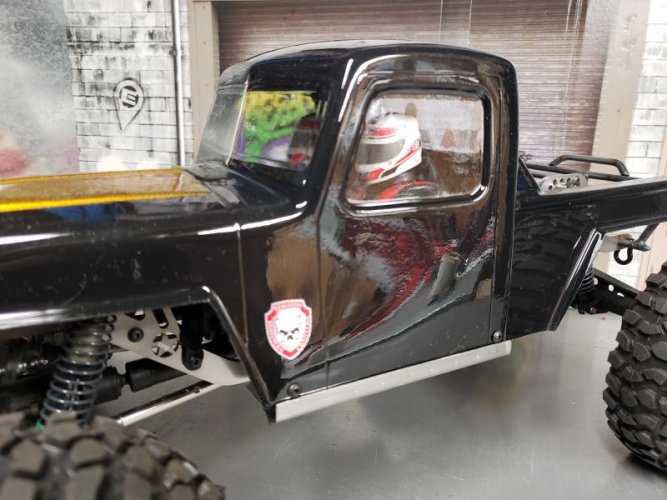

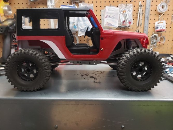

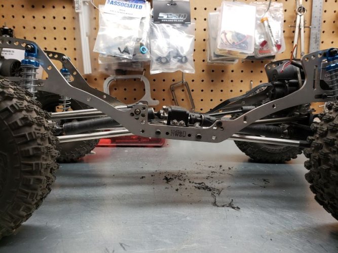

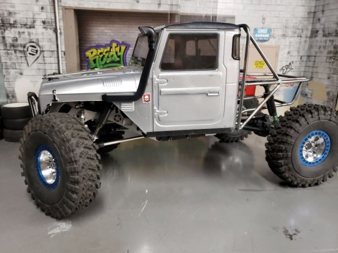

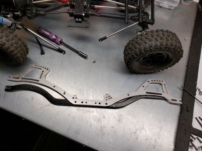

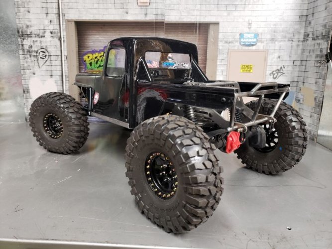

I have one but haven't decided on a build direction yet. I did put it together for my JK build, but ended up not wanting to undo what I had done already with the stock chassis. There are definite advantages to it, like lower center of gravity, angled skid, shock and link geometry adjustments. All the stock chassis parts will bolt up fine, but you will need some 3mm x 5-6mm spacers for the upper link mounts at the chassis for the rear links and for the front upper third link if you choose to use the chassis optional holes. My setup uses a Deadloc t-case and skid and modified steering.

thank you so much for the info and picture! Wonderfull build! The picture were you have the two frames (stock and nwsd) ot top of each other is very helpfull, thanks again
