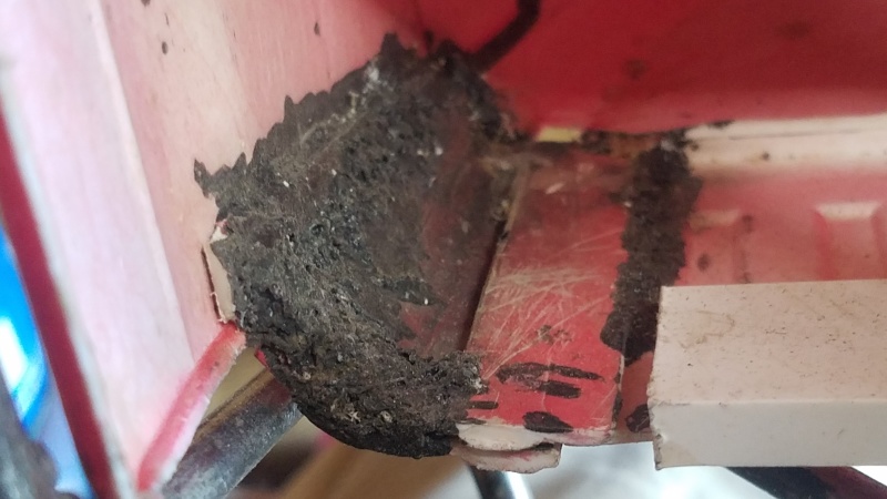

i used the ic2000 and shaved extra plasic peices in to it and went about 1/4 on each side of the joint
its held for a good 5 years now on multiple bodys

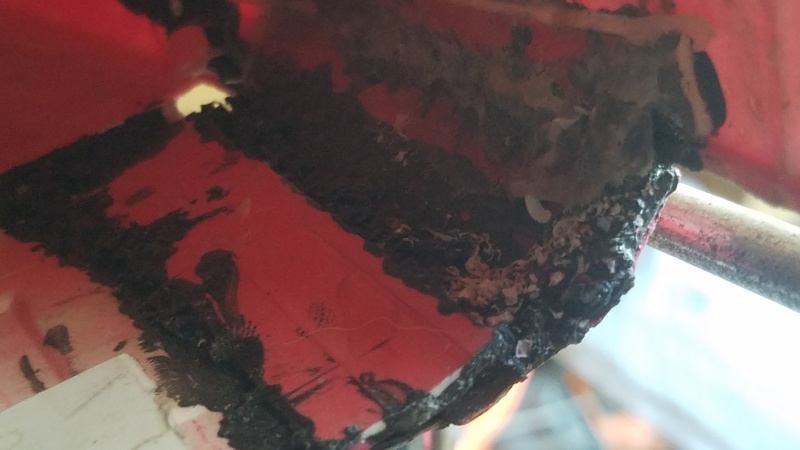

also ive had good luck using small peices of plastic to bridge the seem and useing shoegoo auto and clamping the seem and just using small peices and going one peice at a time

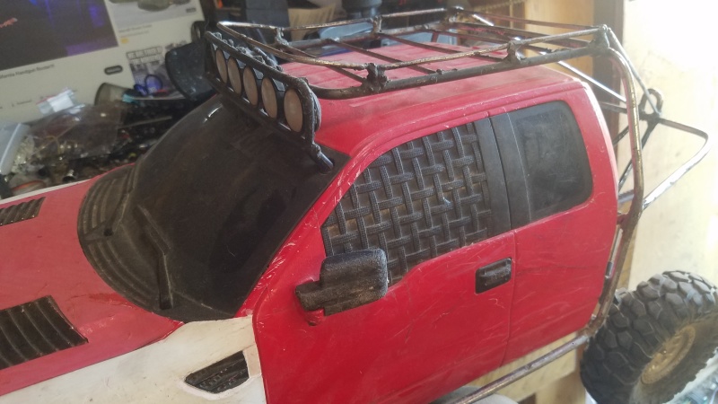

ya that looks like it way to much though thats crazzy
i think the blue plastic holds up alot better on the trail but might be alot harder to do what your trying to do with it

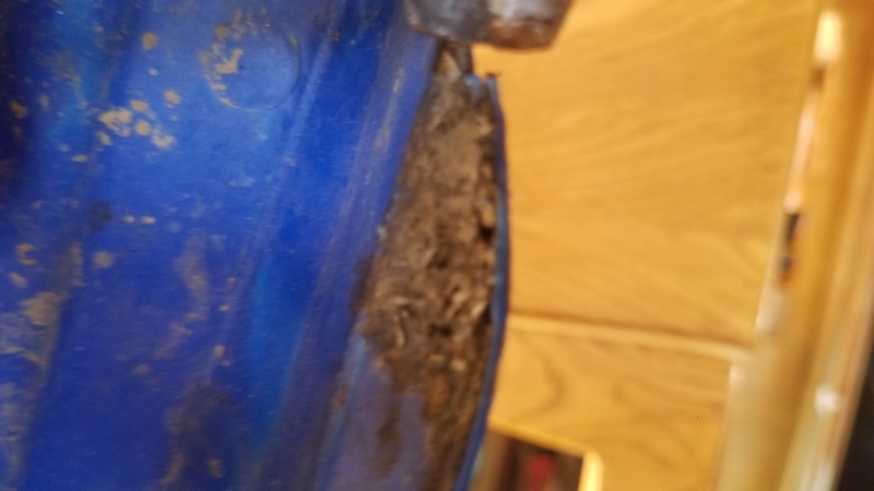

heres the blue body the front half of the fenders are glued using ic2000 and plastic shavings also the start of the lowrider drift truck lol

her are some pics of the joints on the inside there ugly but there holding the blue one has been like that for years

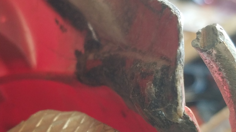

Ferp, is your body brittle? I just got a grey styrene one in the mail and it basically fell apart on me.

i used 1mm styreen and sho goo auto formula to back the seems and its holding so far its also had a few other cracks here and there but its taken alot of abuse like flying 20ft off the top of 1 rock and landing square on another rock type of leaps
i wouldent give up on those the gray one should glue back together pretty good use jb weld as body filler and back it with this styreen and somekind a flexible glue e6000/shoogoo or something like those
