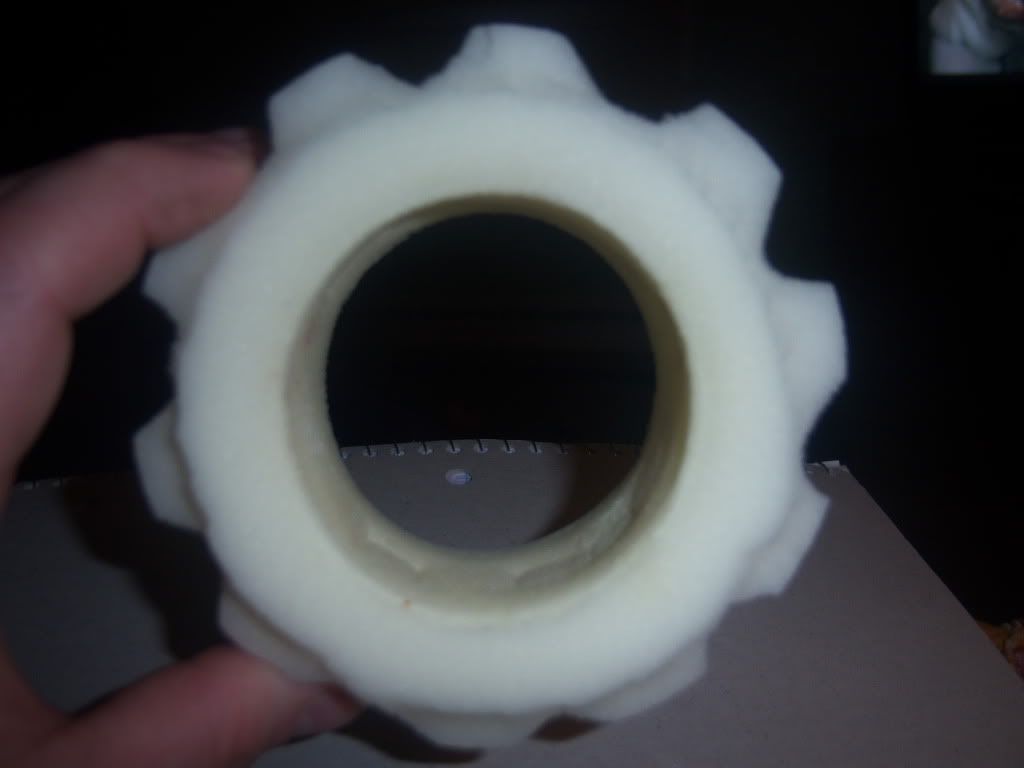

Second: Depending on the type of foam you will need to do some cutting. For memory foam you don't normally need to do any cutting. With standard form you should cut them like stars or a better explanation would be make them look like a gear. On my foams I made a template out of cardboard so that all four were cut the same. You may also need to trim the edges to get some more side biting. I'll look and see if I have any pics to help you out.
Well I found a few pics. Hope they help.
