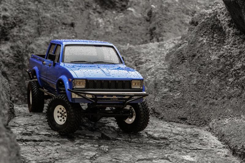

im looking for some 1.55 wheels for my SSD Trail King with a 4 door RC4Wd Hilux body, and i want some wheels that doesnt stick out of the fenders too much. i guess the Trail King is same width as the SCX10 II.
i want to avoid fender flares, but i will consider them as a option if absolutely needed.
i would like it to look something like a stock RC4WD Trail Finder 2
https://www.rccaraction.com/rc4wd-trail-finder-2-truck-kit-lwb-mojave-ii-4-door-body/

TK/10ii axles are wider than a TF2 axle. Most wheels will stick out, and quite a bit.
Maybe if you get some deep dish wheels then bolt the hub on the front face so the hex is sucked deep into the wheel?
I put a Marlin body on my 10ii, and almost the whole wheel stuck out. Granted, I did have 6mm extenders on both sides, but they still stuck out without them. You can see pictures here: http://www.rccrawler.com/forum/axial-scx10-ii/622818-sln%92s-axial-experience-9.html
SLN is right, its tough to not have some poke with most bodies.
I'd also recommend looking for narrow tires too, the Pit bull tires in that video are nice and narrow but they are 1.9's
I'll say the best way to get narrow is a narrowed axle. BeefTubes makes narrowed SCX10.2 axles, I was able to get a 8 1/4" track width using them with regular old SSD wheels and the PitBull A/T Hardcore Scale R/C Tires (same tires from the video). With a similar wheel (in terms of offset) my Trail king has a 9" trackwidth.
With a narrow wheel you do have to worry about whether it will clear the knuckle which is why there arent too many narrow offerings
