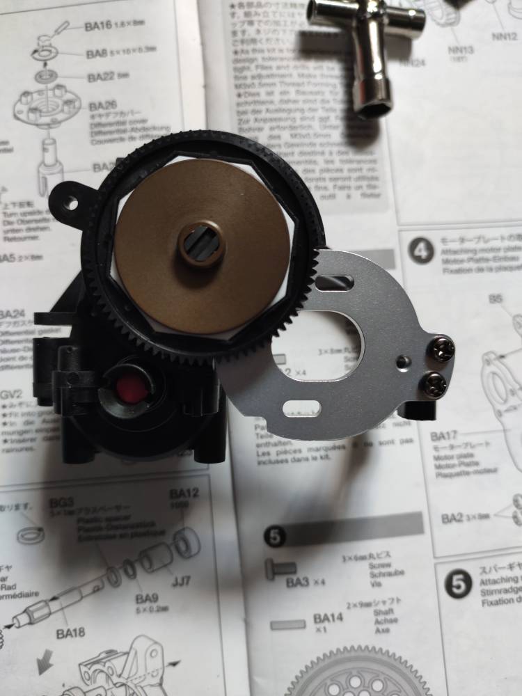

For the moment I'm at the slipper clutch stage :

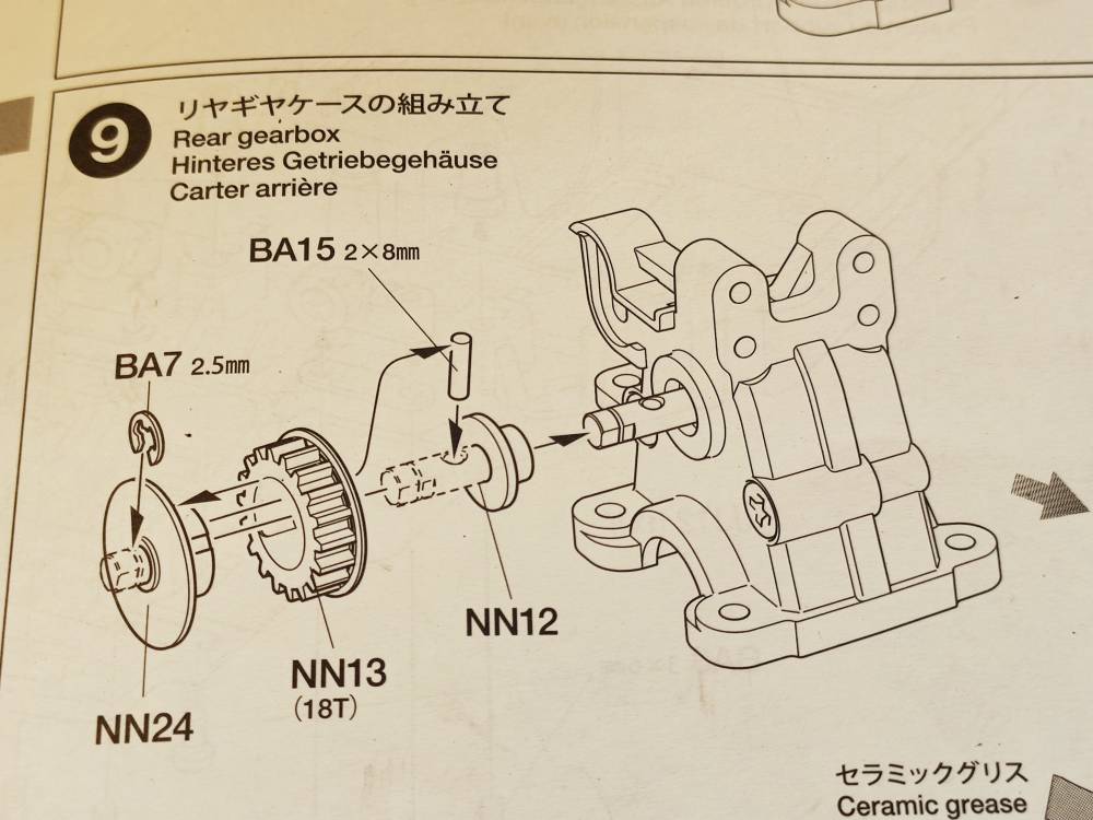

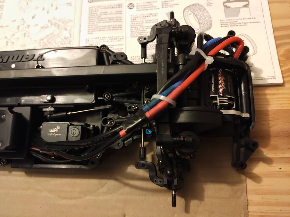

Update : after changing the position of the engine and successfully tested the electronics (which gave me a headache [emoji856]), I mounted the wheels on the chassis and made a little driving test.
Unfortunately I cannot understand why the car behaves like a traction, I have 0.001% propulsion on the rear axle.
I checked the belt and the pulleys and everything seems OK, but as soon as there is any resistance (just a finger on the rear tires) I have no power in the back.
Do you have any hints?
I thought of a big difference of oil in the gears of the differentials (I forgot the references but basically more dense in the front)
OP you're off to a good start, looking forward to more rally goodness! :)
Sounds like there is a cross pin missing somewhere.....
Yes, cross pin, spider gear, shim....something's not proper inside the differential.
I found: the two pulleys tended to get loose because I had not pressed the two plastic pieces NN24 and 13 enough (it was so hard that I thought I'd break them).
Thus there was no place to properly insert the circlip in his seat: as there was traction the exagon of the pulley came out of the small iron pin BA and therefore no more traction.
Now I have tightened plastic pieces but I hope that the two e-rings will hold (I folded and covered with glue once installed).
