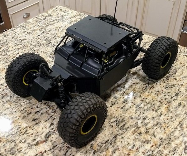

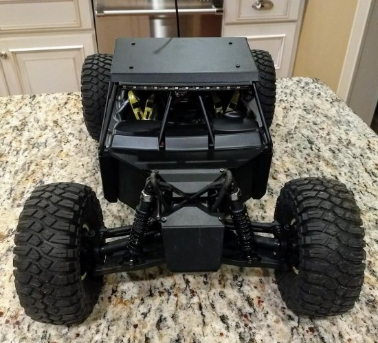

Hey everyone,
I have had the Rock Rey for a few weeks now I've got to say this is a really impressive truck. Power is plentiful and I am impressed with how rugged the bulk of the truck is. Few things though I wanted to change (as we all do), and need some help.
I locked the center and recently the front. Originally I started with the super soft silicone ear plugs in the front diff, felt great but got chewed up after a few battery packs. So I went fully locked upfront and about 10 minutes into my run twisted the front plastic drive sliders. I have a feeling I didn't do a good job with the silcone ear plugs so might give that another go.
Does anyone know of a stronger set of front axles? I'm of the thinking that it's not a bad thing to have a cheap plastic weak point in case something has to give, but I am curious if a better set of front axles exist? Saw the HotRacing ones but didn't read any reviews.
Also, has anyone figured out a good way to take some of the slop out of the steering? I hear the stock servo horn is junk I haven't broken mine yet, while I'm in there I wouldn't mind making the whole steering system better. Ideas?
Attached a few pictures. Mod list is very short right now. Just locked diffs, HR rear driveshaft (time will tell on this one), a 10t pinion, and body panels I got on Ebay. I imagine the maker of them is on here, really nice work. I plan to go with a sensored system and a lower kv motor. I really don't need the speed this thing is capable of on 3s, 2s definitely works better for my purposes.

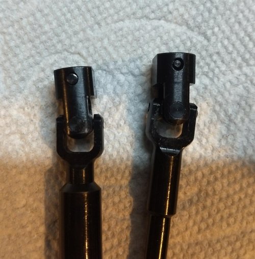

Thanks a lot for the help. I actually just returned the SSD rear driveshaft. Thing looked bulletproof, attached a picture showing the pin that came with the axle on the left, and required stock Losi pin installed on the other driveshaft. Considered pulling the diffs and heading over to the drill press but got lazy, now I wish I gave it a try lol.
I will be giving the diff putty a try for sure. After locking the front/center diffs all I could think about were the tiny diff cup screws :lmao:
I think I'll give the Exotek diff cups a try along with the third member with bigger bearings.

In regards to the drive shaft I didn’t do any modding to the pin and it lasted well over a year of hard bashing and rock bouncing lol
