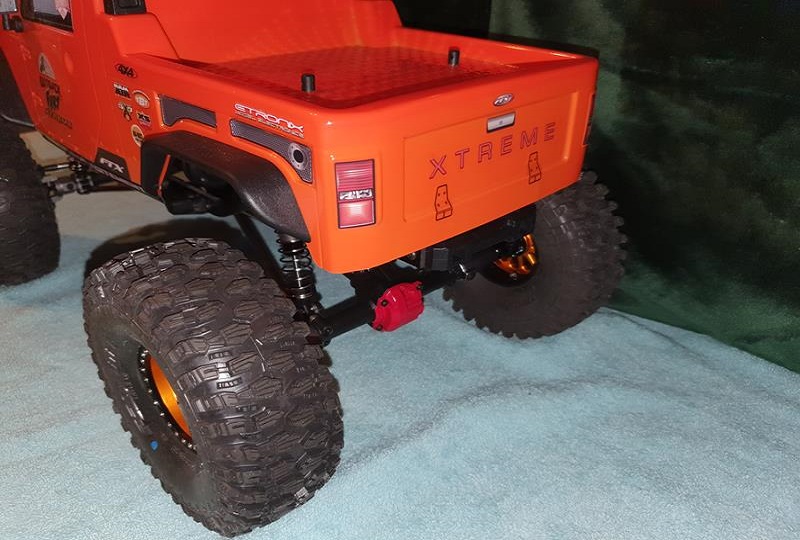

2.2 bedlocks alu, waiting for my new Proline 2.2 Hyrax tires,
they will Arrive tomorrow.
Removed extra spare wheel rear, and cage removed rear.
Save some weight, from rear, looks better also atleast i like this clean style
better.
Here is the Hex wideners mounted

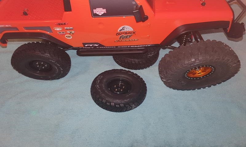

This is how the car looks stock. With spare wheels, and stock wheels , how it arrives in box

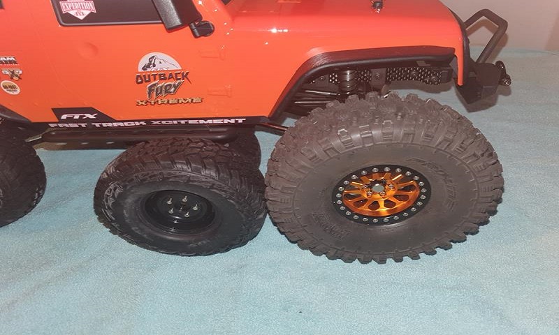

Tires did arrive today.
Hyrax 2.2 Predator Super Soft.
I have mount one so far. Many Screws. Hard work :roll:
I will do two per day. I use Marine grease at the screws so they dont
stuck there.
I need cut this body Comp Style because the wheel-size.
And i need more wide wideners also. I have 15mm wideners now.
Need change to atleast 20mm, maybe 25mm
Rims are cheap Bedlocks from Aliexpress, 32$ all 4 with shipping.
I have another set of these in other color, and they are good.
Only down side is alot Screws in this model. Hard change tires later.

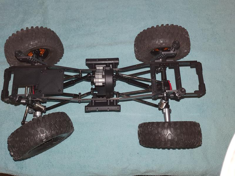

All 4 2,2 Proline Hyrax Predators mounted on alu bedlocks.
I keep these 15mm wideners.

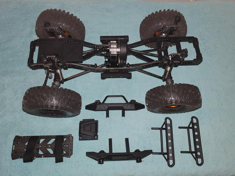

I have remove Bumpers. Radiobox. Battery-tray Side trays.
I did Strech the Wheelbase to max. From stock 313mm to 328mm / +15mm
Did some shock work, and also filled more grease in diffs.
All driveline grub nuts changed to better brand: TEKNO and Red Lock Tite
Check everything and added more Blue Lock Tite where it needs

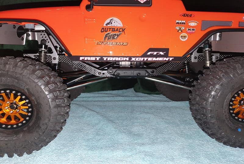

Compared to stock
This is now +15mm longer Wheelbase
2" wider , 1inch every side, 15mm wideners, and new wheels 10mm offset
Bigger tires and shock work has made this about 1inch higher. So 25mm
more Ground clearence.
More wide+longer+higher Ground clearence "thumbsup""thumbsup""thumbsup"

Ground clearence is amazing now.
And it is perfect wide with these +10mm 2.2 wheels +15mm wideners
Finally im happy.

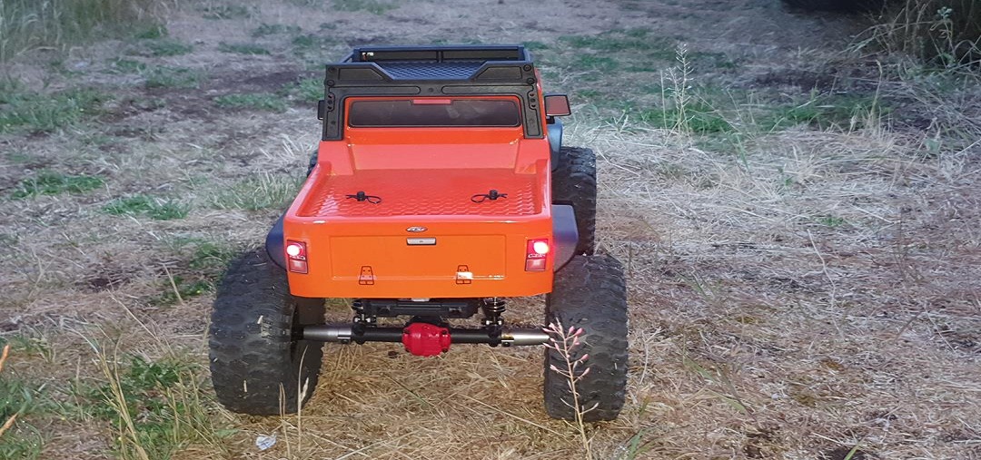

Body sits 10mm higher now than in Last picture.
I did use Arrma 1/8 Longest body post. They fit perfect in this rig. No mod needed. Only the Body need bodypost trim because the Arrma ones are Thicker
1/8 scale, they are very strong.
I can also lift it more, like 10mm more still. Awsome
