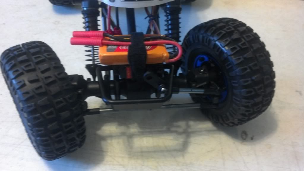

the built in battery box for stick packs! luckily it just bolts off and on, so that will more than likely go, since i am running lipos over the front servo.

it has fairly decent steering for an RTR. the included servo "claims" to be a 9kg unit, but, i plan on replacing it with a towerpro unit soon.
it's a bit wide, but i think with wheels with the right offset, that can be narrowed up a bit
