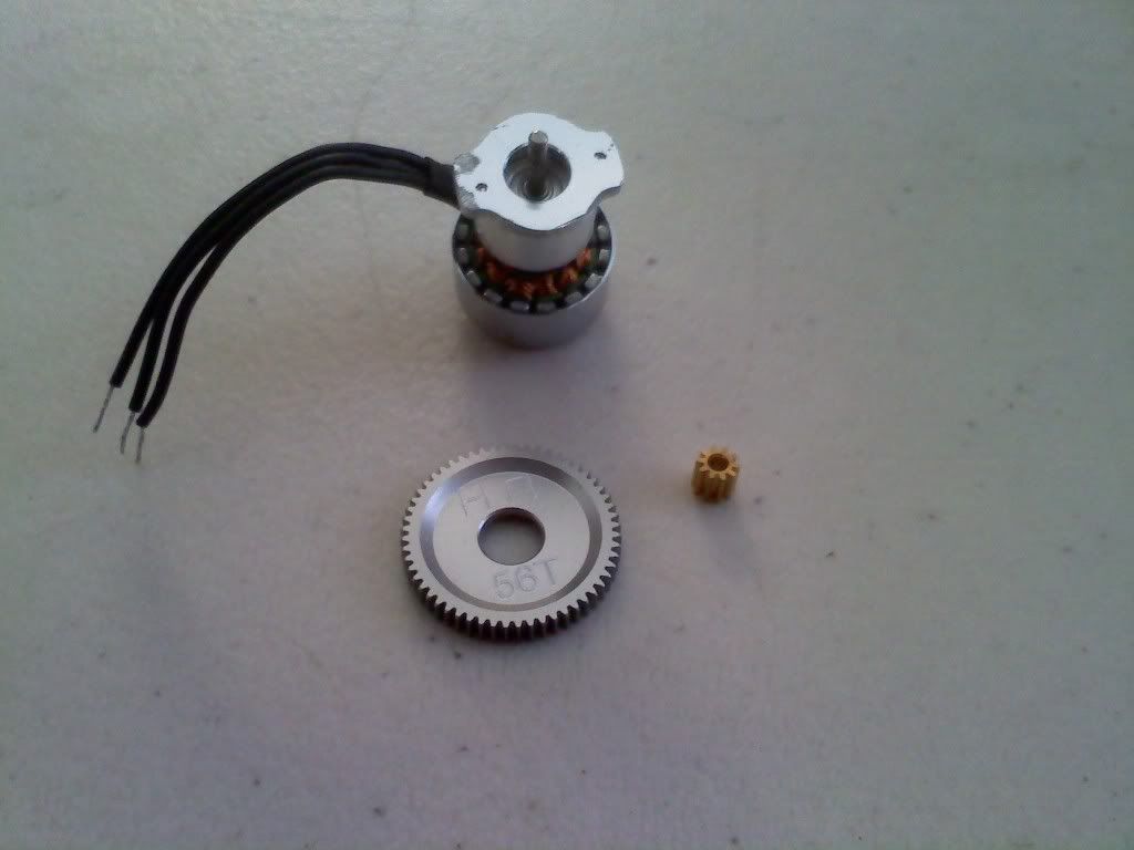

heres the best brushless micro setup IMO! and as far as all other motors theyve been tested on the Micro T Forum extensivly and this is the best out there.

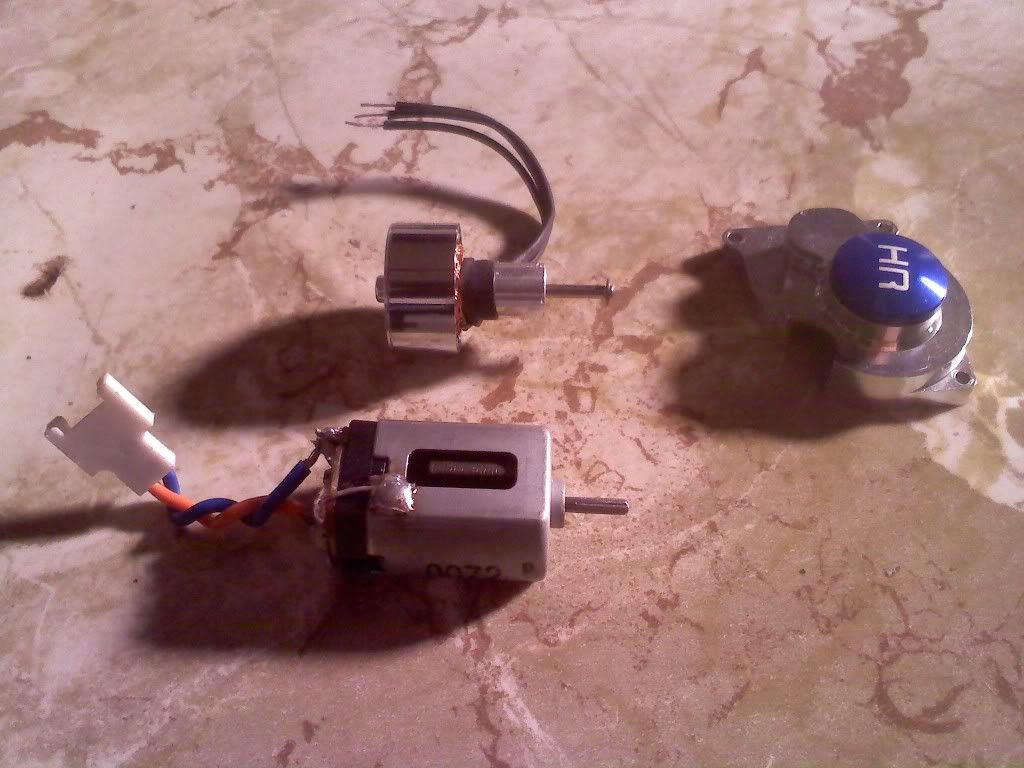

2000kv brushless outrunner, $10 super light and small( not a fan of the long can for crawling) but its not a bolt on its somewhat complicated making a motor mount and taping the holes lining everything right.

BTW EGGOZ CRAWLERZ any info on that brass pinion? where did you get it? Ive been looking but cant find exactly what i need, or if i do you have to buy a large amount
Its from hobby king. as far as i know its the only micro out runner I've seen used on the micro losi
from what ive read on the micro T forums in the crawler section you have to take the motor apart and push the shaft out the other side and make a new motor mount
his post should still be near the top of the Micro crawler section on Micro T forums, same guy that did the 4ws and other mods

hextronik 5 gram brushless outrunner hobby king has them but that takes 2 weeks or more, my esc took 2 months. but there are some companys that stock them in the us and ship faster.
brass pinions: ebay seller benmlee has them under losi micro rally brass pinion, plastic ones melted on the rally!
also i saw the 5 gram outrunner on ebay in the usa too. i found mine for like $10 in USA.

The outrunner is by far the best - crazy torque and runs forever (super-efficient)... also has super-low speed control too... Search "CreepyG" and check out the vids i posted...
