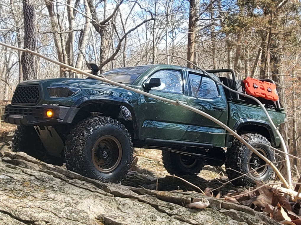

FYI, not a damn thing wrong with krylon camo paint on lexan bodies. I painted my stock body with it on the outside because I couldn't get a clear body kit and didnt want silver. Biggest thing is making sure the body is CLEAN including a final wipe down with rubbing alcohol.
Krylon body only scrapped off on rocks, no flaking or anything.
Just painted one with ordered color matched automotive paint, color to match my 1:1 now that I got a clear body for it. Had one extra step (plastic adhesion promoter, light coat before paint). This body has been flexed and everything while doing scale work, 0 issues.
Now hobbyshop paint, BE DAMN SURE ITS FOR POLYCARBONATE/LEXAN or it WILL FLAKE OFF.
First pic, krylon on the outside.
Second pic, automotive custom matched paint (spray can)
So ignore people that say you have to use whatever, it's BS. Other options work fine, biggest thing is it being design for plastic or using adhesion promoter for plastic.
