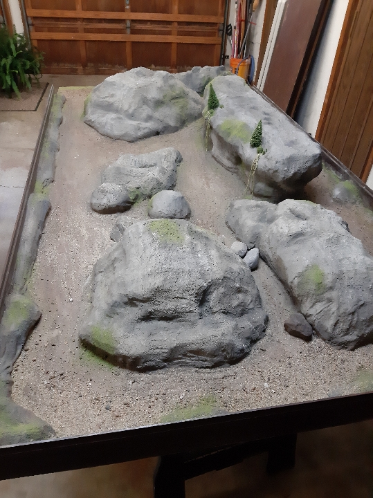

Progress..
Almost done...
Time for the details!

Looks awesome. Definitely something great to have indoors. I'm thinking of doing the same hopefully this summer. It would be fun to be able to drive inside while it's nasty outside, especially in the winter.
