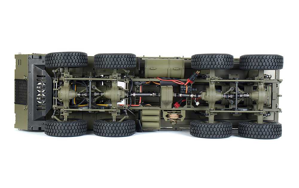

I am considering building a M977 HEMTT. Interested if anyone has built one, how did you handle the dual front axle steering? The easy way is to use a “Y” cable and use 2 servos. Not scale but will work great. I would love to do a walking beam steering system but not sure I am up to the challenge.
I need to find 2 pairs of axles with pass thru drive and then use a center mounted transfer case. Beyond that, I will have to work it out as I go.
See how HG did on the P801
