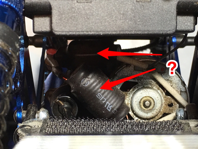

Just a follow up. When I pull out the stock motor, I'm taking out (and keeping out) those capacitor looking components right?
Thanks
