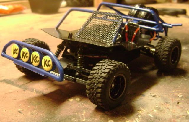

I had already put a The Toyz Short Course Body on the truck and painted it to match my Slash. I picked through the static model parts box and found some offroad lights. Then, I used styrene rod and sheet to fab up the bumper/light rack and make the skid plate. This set up bolts on just like the original skid.

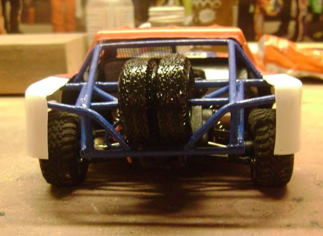

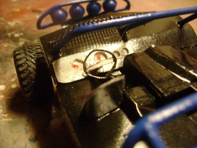

After that, it was time to cut the bed area out of the body and start the tube work. The spare tires are 1/24 scale static model wheels/tires but they are the same size as the ones on the DT. So far the interior consists of a floorboard, seat, and the beginnings of a dash. I need to finish the dash up and at a roll cage. Once everything is finished up I am going to super glue all of the joints and add a dusting of baby powder. That is a trick I learned from static modeling. You can add baby powder or some other powder like that to super glue and get a sandable filler to strengthen joints and fill in body work.

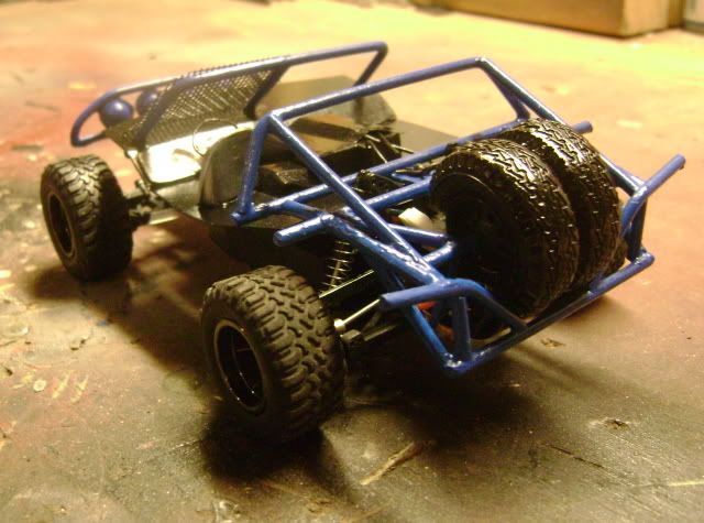

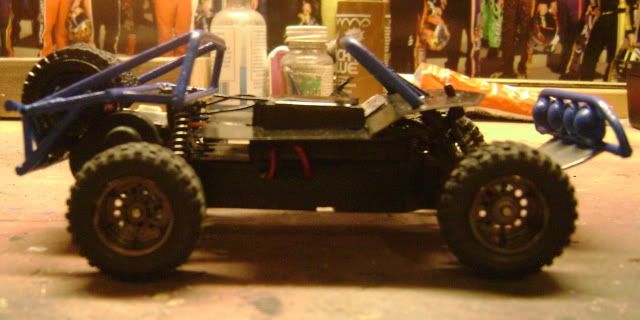

Here are a couple of pics of the chassis and how the tube work mounts. It just sits on the rear body post.

I had some time to work on R/C stuff this weekend so I got the DT finished up. It was a fun build and I am really happy with how it turned out.
Off body shots of the chassis

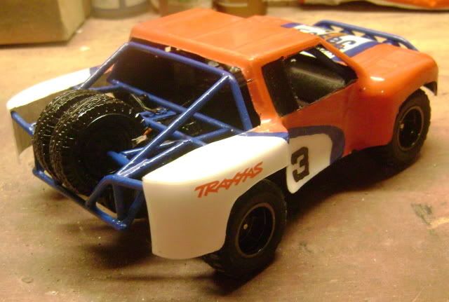

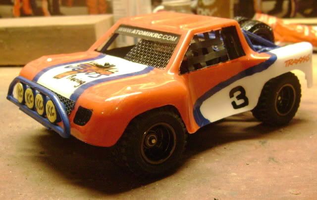

Body on Shots
Nice job, just like it's big brother. I bet painting that little bugger was a bit of a pain.

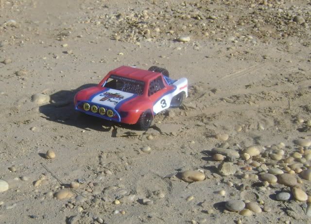

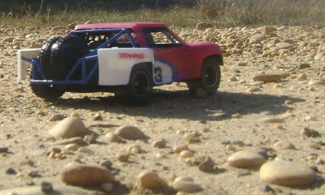

Here are a couple of shots that I snapped outside.
I think the last one looks cool. Thanks for the compliments. It was a fun project."thumbsup"
