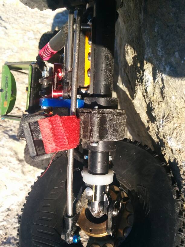

I bought an Berg v3, an bult it with Reptile chassis. vas a bit disappointed with the construction and weight. Found Dravpnir's thread and was amazed.
I decided i rebuild the whole thing.
Started to cad up the axles. Printed some gearboxes. bought axle tubes and gears from Dravpnir. Ordered som Dlux axles and hubs.
Problem i had with the printed gearboxes was that bad tolerances on the prints. gearbox covers was weak. after many hours of work. i was so mad at them so i actually almost bought new axles.
But i thought ill give them one more shot. So i got some G10 gearbox covers for my gearboxes, and it feels so much better. So ill give them a test this weekend we have 6 hours of crawling ahead of us, if it breaks the some vendor i the states can have some money from me. I don't have so many pictures of the build process but posting some the current state.
PartList
Axles
Home designed housings
Dravpnir made tubes
Dlux shafts and knuckles front
Berg v3 gears and axle rear
Homemade Weights
Chassie
Crawler-keller reptile with their berg v3 links.
Wheels
Wheels neighbor made wheels in polycarbonate 3mm.
Next set will be Nordic crawler designs wheels.
voodoo gold home narrowed
DD foams 6.0 soft in front
DD foams 6.0 Medium rear
Suspension
Traxxas Bigbores
Cap mod
jeepindoug mini-t cups.
Mini t pink springs
35wt front
45wt rear.
Electronics
2 x cc micro sidewinder
cc bec
futaba micro receiver
Tekin 35t handwound 540.
Weight
1940g with 450mah batt
Weight distribution approx 60-40
