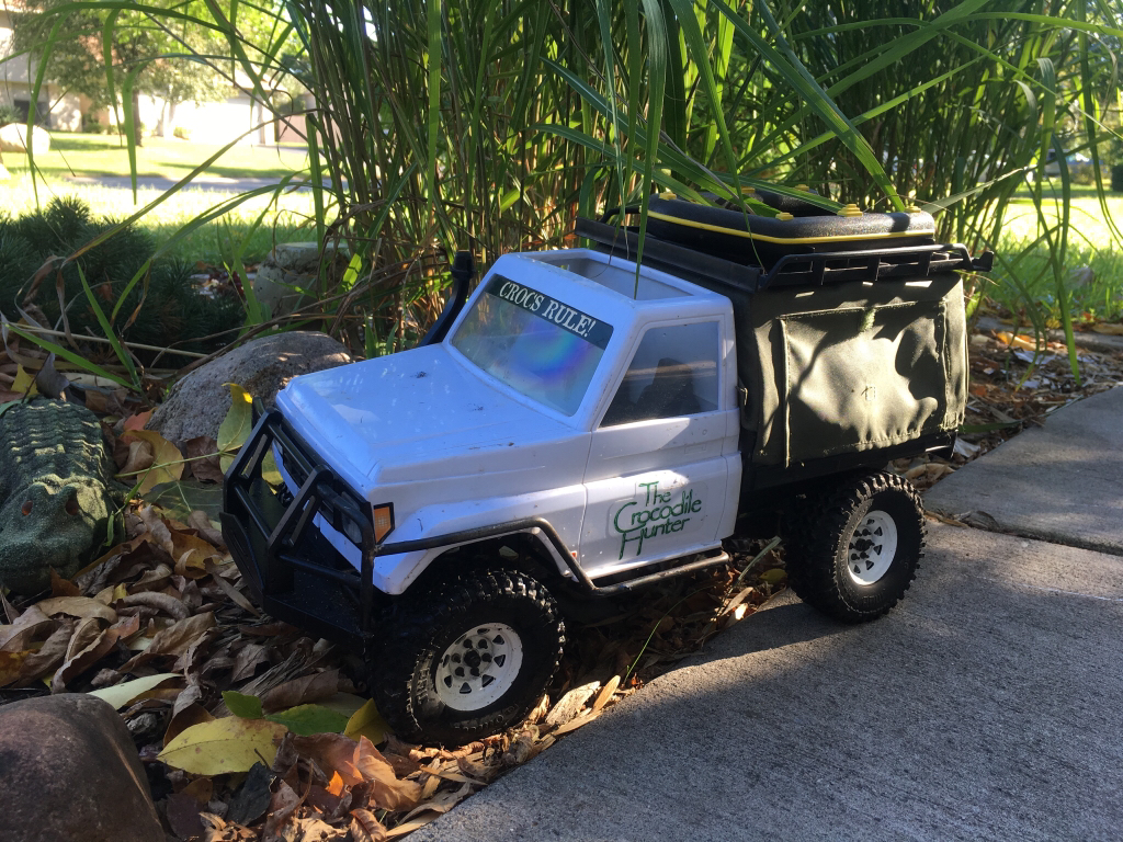

Someone built one on here with a Croc hunter body and did leafs on the rear, but I can't find the dang thread. It's here somewhere.
Yep, I did it in the rear of mine with tf2 leafs. I extended the chassis and it works well, not sure you could do it without the extension.
I made some u bolts to attach it to the axle.
