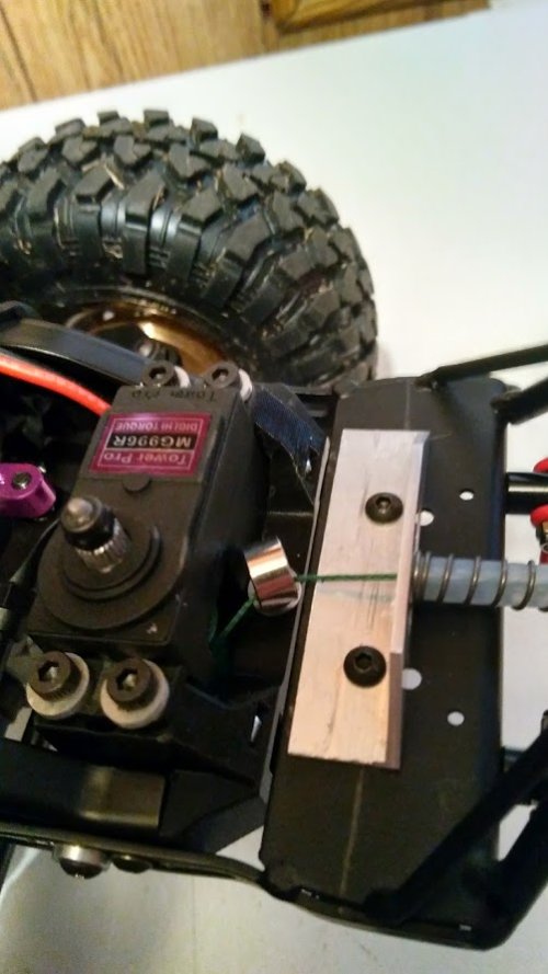

I finally received a servo winch mount [ebay ] had to do some cutting on the new mount to get the K3 servo winch to fit , plus added a collet to center the line on spool. I would say the mount was made for the bobbin style servo . Trimmed the front of body and made a fairlead to bolt to bumper . Using a Heyok Wireless winch controller to run it , power from extra wire off ESC...

Have you checked out the Bowhouse rc mount on shapeways? It looks to be a better setup for your style winches.
Yes,, after,, I bought this one I seen it , It looks to be a better fit than the one I bought for 17.95 , maybe later on I will try BowHouse servo winch mount , They look like they might fit the SCX10 ,,"thumbsup"

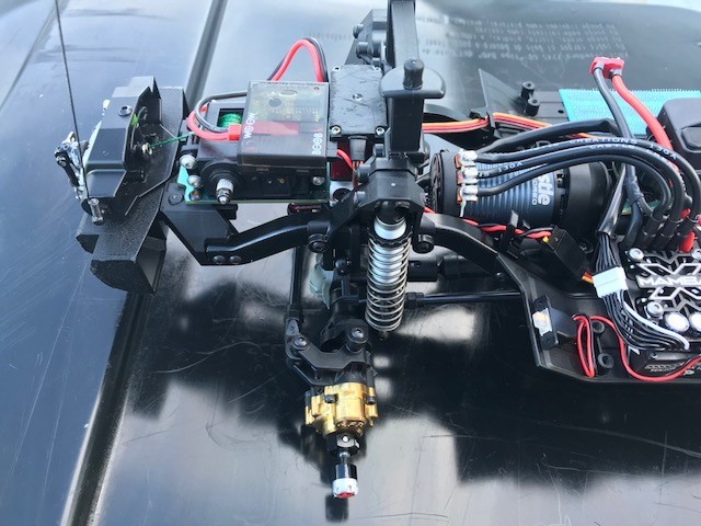

Here is my solution, this plate. Pretty simple. Screws into the rear flipped bumper mount.
Original set up with line line being sent through TRX winch on narrowed TRX bumper.
Current using a 3D printed aluminum bumper for more clearance:
Love the KMS winch though.

I'm using the crawler innovations electronics tray for a mount
