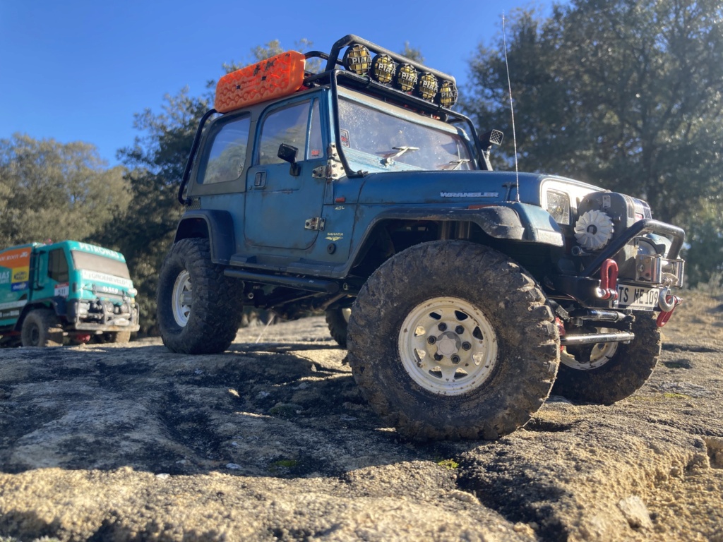

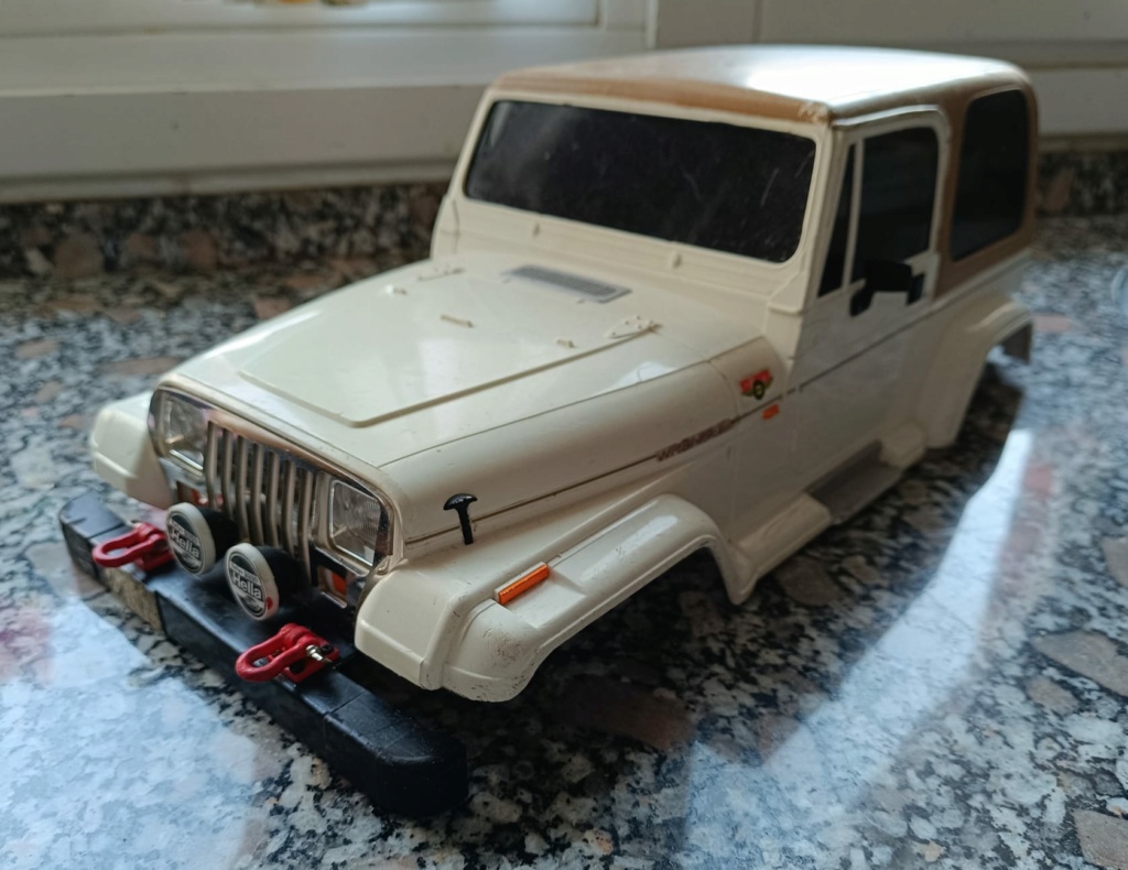

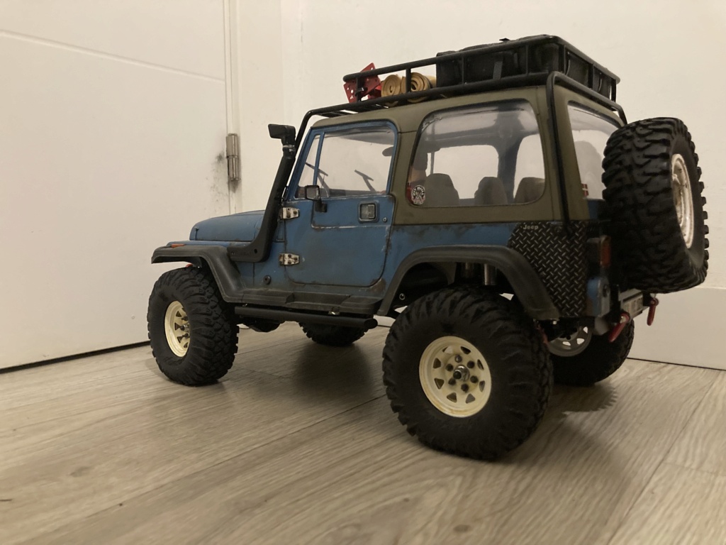

I couldn't let it escape, with that decoration it reminded me so much of him...:

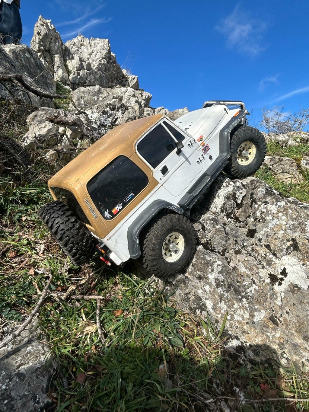

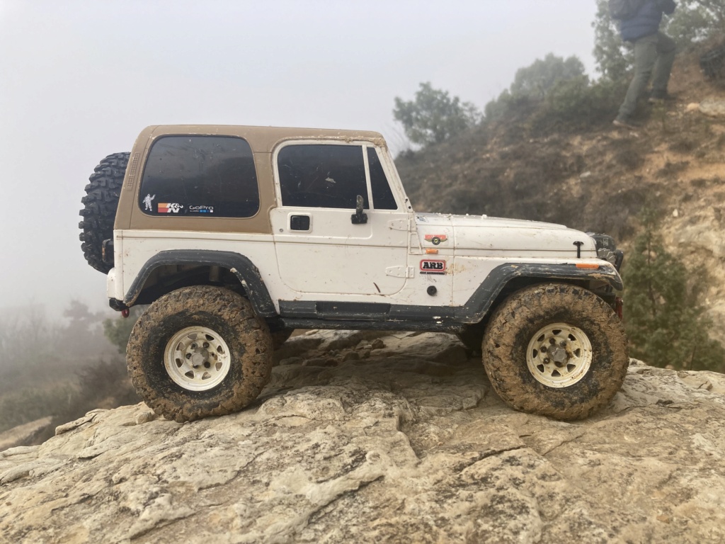

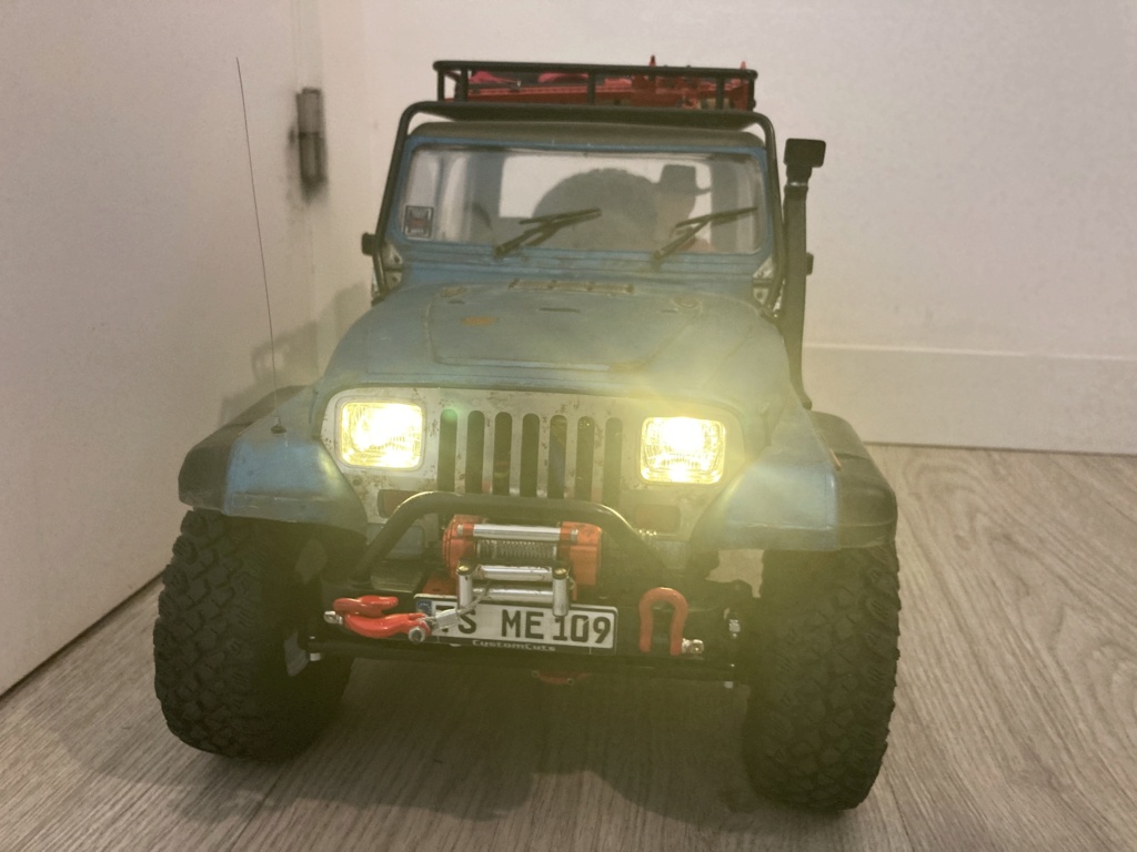

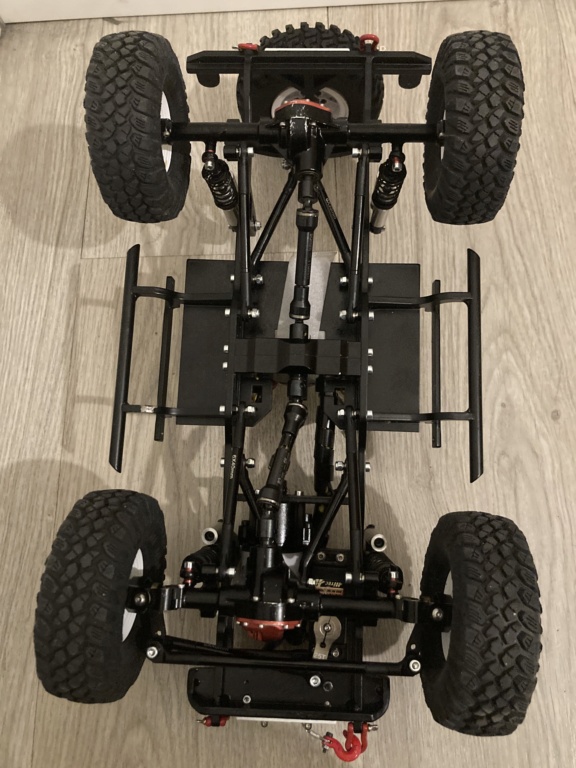

and this is what I received, this afternoon I will start with it, cleaning the inside with ultrasonics, regreasing, 2-3mm more wheelbase, 8274 winch and new fusion 1800 electronics and 45kg SRT servo
It is already checked and oiled, the truth is that it came in excellent condition, a great seller. And after trying things, it definitely stays with that electronics, I thought it was a weaker servo but no, it's good enough.
The 8274 winch could perhaps make room for it but it is very tight on its bumper and the 9.5ti doesn't fit either, so it stays with the one it is.
The shock absorbers leak oil, like all those models, but they have been checked and work very smoothly, I adjust them to my liking and otherwise I would say that the car is ready to ride.

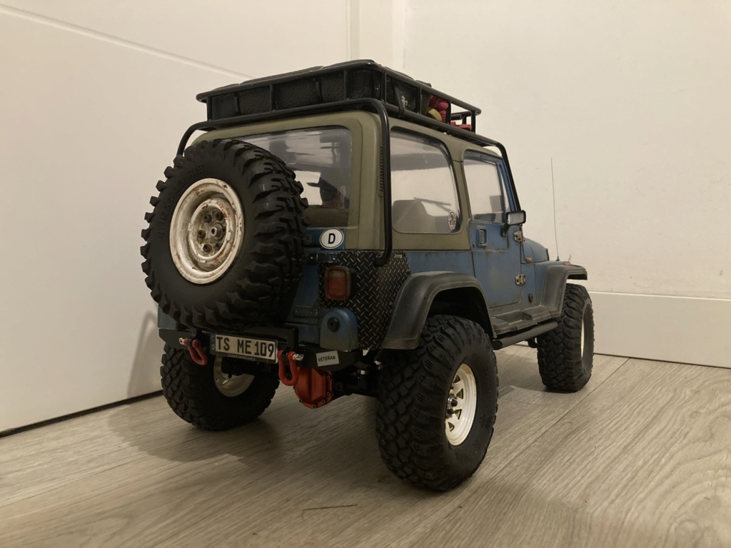

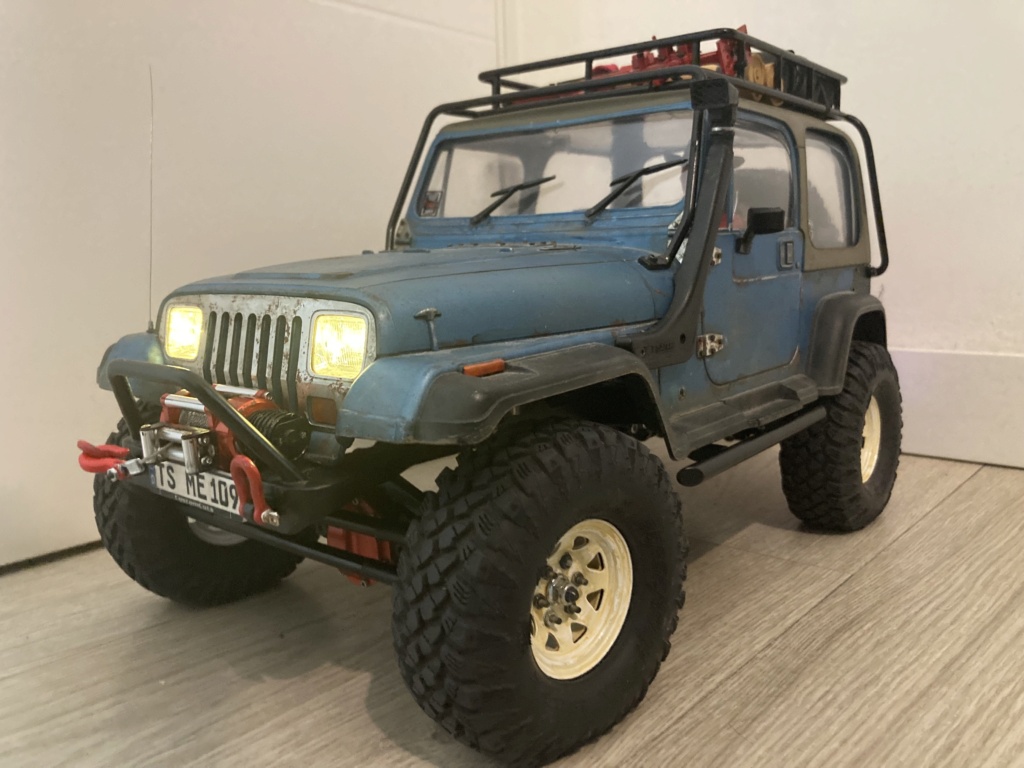

Today I will put some matching lights on it and as you can see in the photos I already put some stickers and decorations.

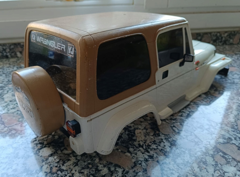

Not really, there was only Newbright but there are fewer left every day, just like the Tamiya one is difficult to find... anyway, where the prices are going lately, I don't know if it's interesting, because 3D bodies at more than 300$ It seems like an abuse to me when better made, better detailed ones from any brand without the need for 800 hours of sanding are in 200
The patina and scale details look so good! Seeing this is making me miss my 1:1 YJ that I had to let go a couple years ago.

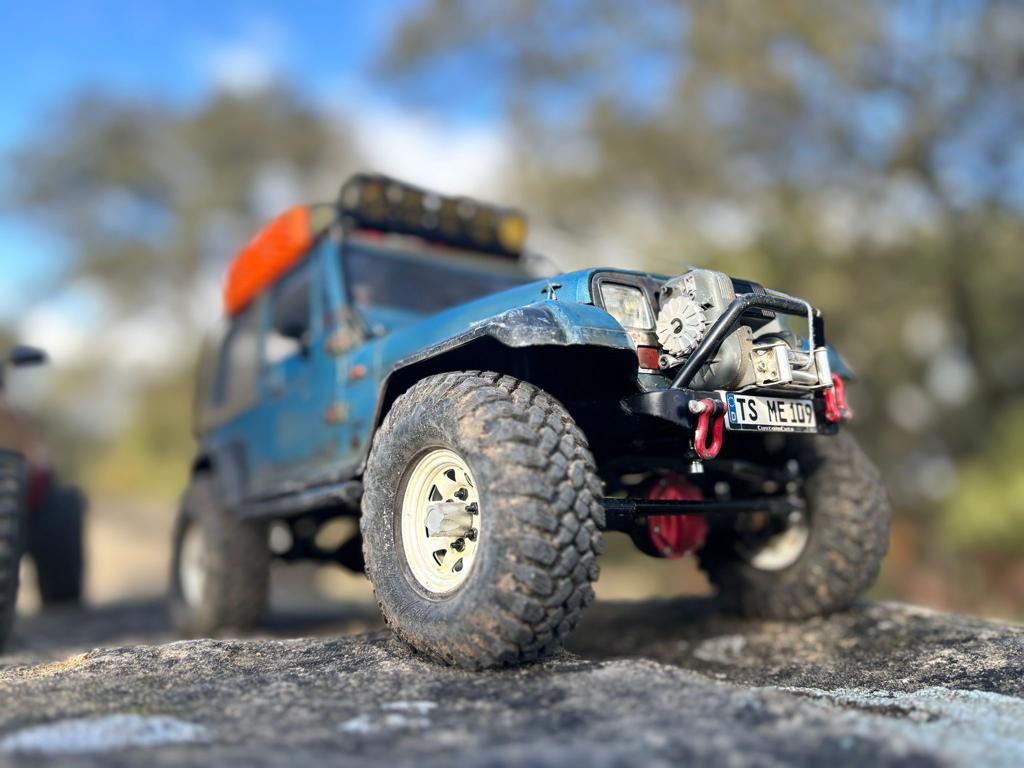

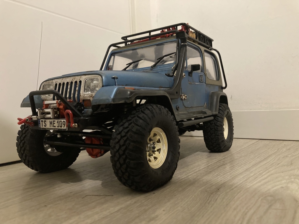

Is that running a front motor with an HPI reduction case?
