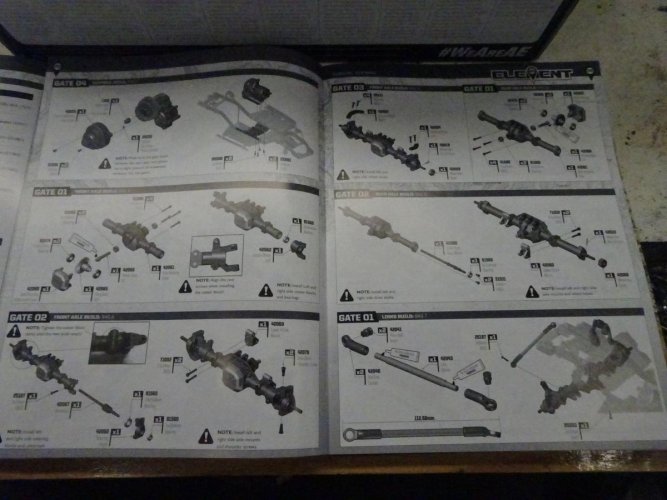

Trifle #1: Associated has included a 1:1 layout of all of the different hardware pieces on a fold-out flap inside the front cover of the manual:
At first, I thought this was a great idea. But as I got further into the build, I came to find that flap bulky (it takes up 1/2 again as much space as the manual opened to just 2 pages). I prefer the approach taken by Axial/Traxxas/Vanquish of simply showing 1:1 images of the hardware needed on each page for the steps on that page.
Trifle #2: The technical writing team came up with the clever idea of referring to steps as Gates instead of steps. It's a neat idea, but re-starting the gate numbering with each new component just makes the whole numbering thing kind of confusing:
Suggestion for next time: keep the clever "Gate" terminology but start at 1 and keep going until finished. ;-)

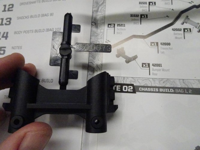

Trifle #3: The part numbers shown in the instructions do not match any numbers found on the parts trees:
That basically means you have to pick parts based on shape/size instead of numbers. It's not a deal-breaker (the only place it got a bit tricky was with shock towers, and those have small letters molded into the inside to indicate F vs R and L vs R). But it also wouldn't have been too difficult to get the numbers to match.

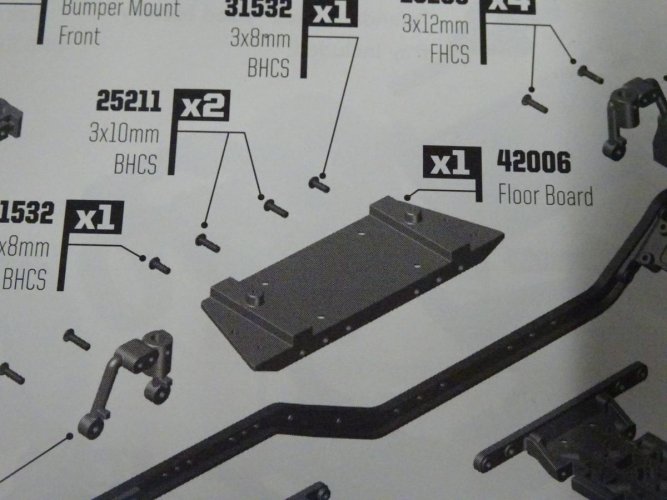

Trifle #4: The first 7 pages of the instructions lack lines and arrows showing where screws are to be inserted. There is at least one place (attaching the skid to the chassis rails) where those would have been helpful:
The screws in that picture should go into the outer 2 of the 3 holes on either end of the skid, leaving the middle 2 holes for the upper link mounts. Fortunately, it's not too hard to figure things out, and the manual drafters remembered to add the lines beginning at page 8.

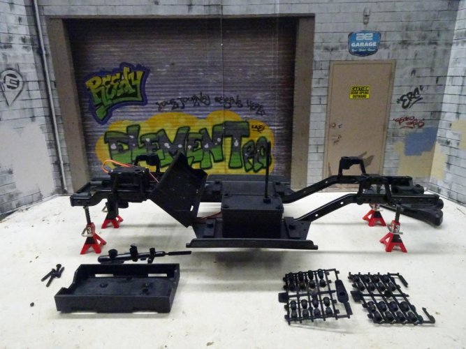

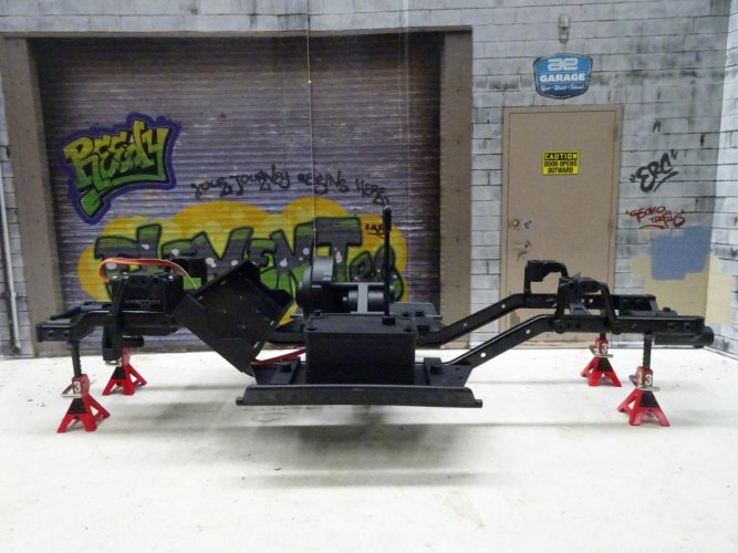

Quibbles with the instructions aside, the chassis goes together quite nicely. Here's a look at the assembled chassis:
See what I mean about that garage background? It looks killer. If any of my full size vehicles came with a garage, I would have saved myself an awful lot of 1:1 money:
But I digress. Back to the chassis - notice that you get your choice of 2 battery trays. I opted for the wider one so I had the option of using larger packs for longer outings.

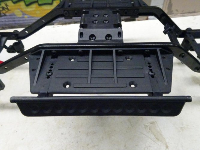

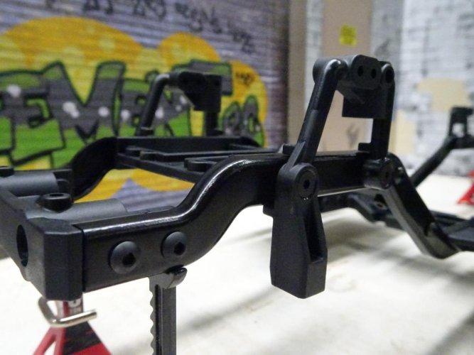

The biggest chassis issue I saw on initial assembly is the panhard mount:
That's an awfully long and flexy piece of plastic for a part that can end up under a fair bit of stress. I'll be looking to swap that out sooner rather than later.
There are also a few nits to pick here. For example the hole spacing on the skid is close to Axial hole spacing, but not close enough to be interchangeable without modification/massaging:
The same is true of the sliders. They use a similar mounting style to Axial's 10.2 sliders:
But the spacing of the slots for the sliders is off by over 1 mm vs. Axial's, making parts interchangeability a challenge. Had they simply made the spacing the same as Axial's, that same feature would have been a big plus.

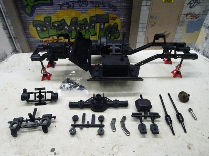

The axles present another interesting mix of features lifted from the AR44 architecture and some new to the Element Enduro axles. Here are the front axle components:
As with the AR44 kit axles, these come with universals:

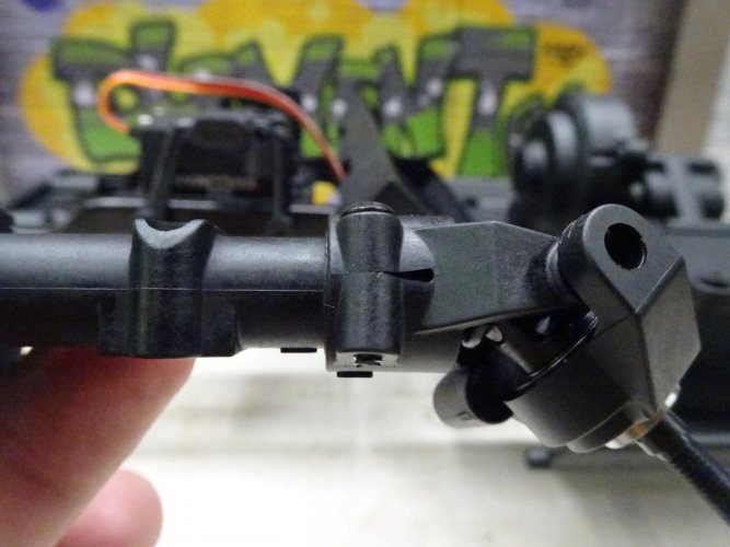

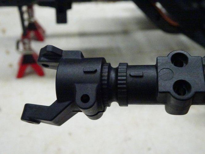

Associated/Element also borrowed the splined, clamping c-hub design from the original AR44 axles and added markings molded into the housing and c-hub to help with proper clocking alignment:
Unfortunately, the clamping c-hubs were one of the weak points of the original AR44 design. The splines were not pronounced enough to prevent the c-hubs from spinning around the axle tube under heavy stress or when the occasional root or weed found its way around the axle. I suspect these axles will have similar issues. To help reduce the chance of this, it's best to tighten the c-hub clamps as much as possible as recommended in the instructions:
You can also drill a hole through the side of the c-hub into the axle tube and insert a screw to help keep the c-hub from rotating.

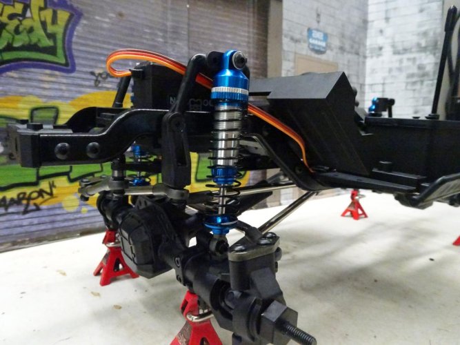

Here is the front axle assembled:
Although the Enduro axles use similar spiral cut gears and the same gear ratio as the AR44s (30T ring, 8T pinion, 3.75:1 ratio), the Enduro design has the pinion centered in the pumpkin rather than mounted up high like Axial's:
This allows for reversing the locker/ring gear, but at the expense of the extra ground clearance provided by the high pinion angle of the AR44s.
The aluminum arms and BTA steering setup are nice touches, but clearance may be an issue with some wheels (esp. those with thicker inner beadlock rings).
Another area of potential concern is the diff covers. Most of the surface is flat, which would make them more susceptible to catching rocks and roots. Here's a look from the side after installation:

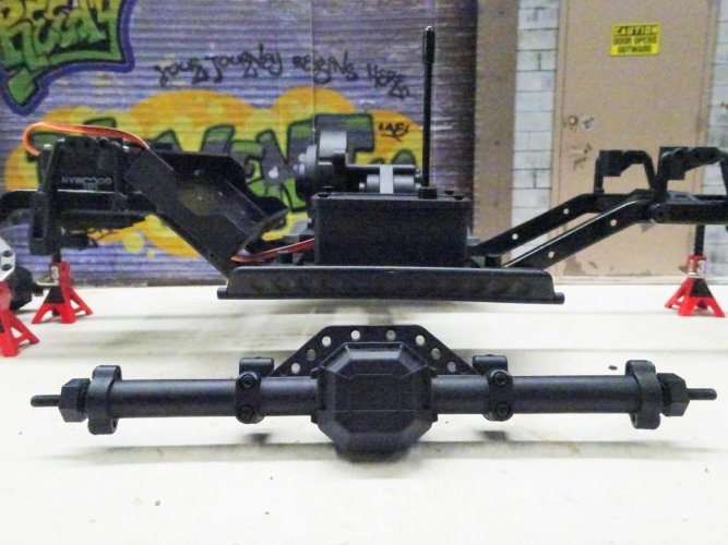

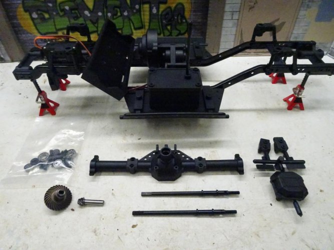

The rear axle also borrows from the AR44. Here are the components:
Like the original AR44s and the Enduro front axle, the rear uses separate lower link/shock mounts. And like the one-piece AR44 housings that replaced the original design, Associated/Element opted to ditch the bearing caps in favor of retaining screws to keep the outer bearings in place:
Note how little overlap there is between the screw head and the edge of the bearing. I suspect this may become an issue for some. Fortunately, there is plenty of room to add an M3 washer and still clear the wheel hex, which should prevent any problems.
Here's a look at the assembled rear axle:

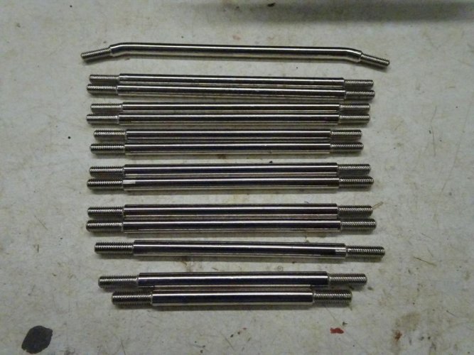

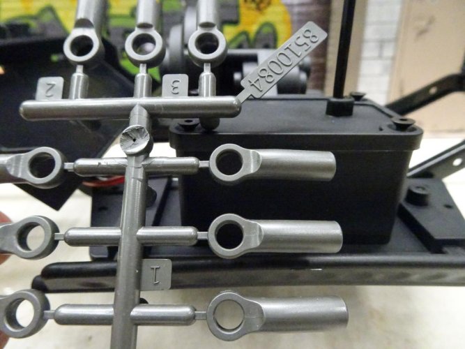

Next up were the links. Here's what you get in the box:
The 5mm steel links have nice heft to them. The rod ends are molded in gray:
Unfortunately, Associated/Element opted for plastic pivot balls like Axial has, and we know how that turned out for Axial (not well). Associated/Element already have released metal pivot balls, so I would recommend going with those straight away. We'll have to see how the rod ends themselves hold up even with the metal pivot balls.
When assembling the links, note that many of the links are very close in size:
The images of assembled links that appear in the instructions are NOT 1:1 size, so you'll want to measure to make sure you grab the correct links at each step.

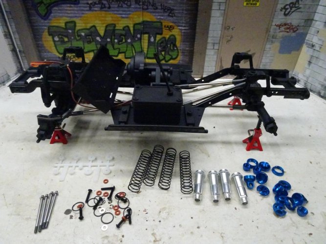

Sorry, Sherlock. It's time to be shocked. But not by guessing, lol. The Element includes aluminum bodied shocks, though the kit version steps that up with aluminum caps and spring cups instead of the plastic ones found on the RTR:

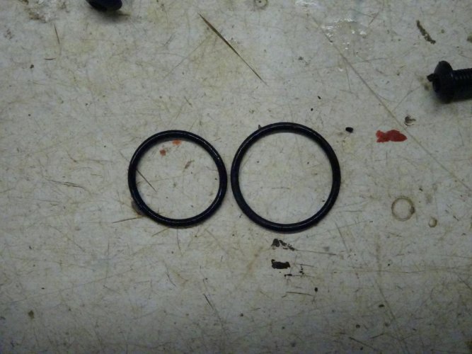

Note that you get o-rings in 2 sizes that are pretty close to each other:
The smaller ones go under the shock caps, and the larger ones go in the spring tensioners. Here's how they look assembled and installed:
The combination of larger diameter and flashy colors make them look a bit blingy for my tastes, but that's up to personal preference.
I went with the included 30w shock oil. If I were planning to keep the shocks, I'd definitely go thicker (maybe 1k diff fluid). But I'll probably swap them out down the road, so they'll stay as is for now.

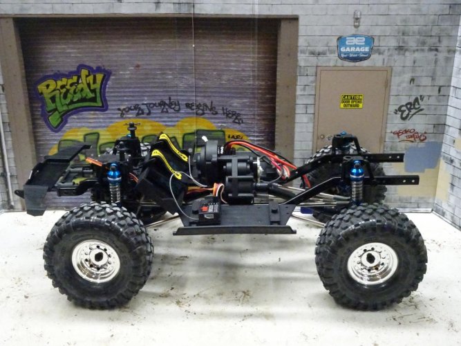

  • I chose the shortest of the 3 supported wheelbases (11.8") for Vaterra's 1968 Ford F100 truggy body.

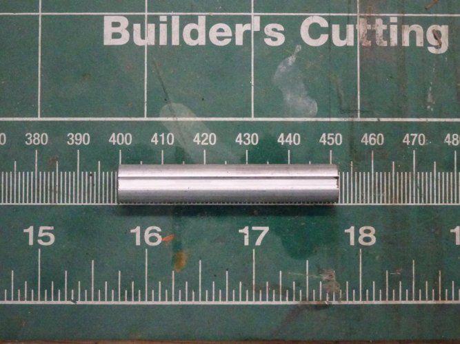

  • There was no combination of included male aluminum inserts and female plastic driveshaft ends that would work for the rear driveshaft without modification when running the transmission with the spur gear facing forward.
  • To achieve the desired driveshaft length, I had to trim both the longer metal male insert (from 60mm down to approx. 52mm) and one of the female ends.
I must be about as far from an ideal reasoner as possible, because I never would have been able to figure all of that out from one picture. Fortunately, I lived it, so I'm happy to spare you from having to deduce those details all on your own.

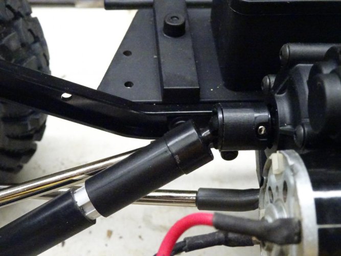

One other relevant fact to share has to do with driveshaft angles. Particularly at the shorter wheelbase, they are not ideal, to say the least:
These angles result from the combination of longer outputs than the AX10 tranny (necessitated by the parallel gears used for the overdrive feature) and center pinion position (vs. the high pinion of the AR44s). We've started working on a solution, but there's not a lot of room to play with.
In keeping with the budget theme of this build, I used most of the electronics (radio/receiver, AE-5 ESC, 35T motor) that I took off of my 1.9 Wraith RTR plus an inexpensive servo to get things underway. Here's the basic setup with body off and a set of Traxxas take-off wheels/tires for mockup purposes:
Initially, I had only a 15T pinion sitting around (not the 18t recommended in the manual). On 3S, this setup was dreadfully slow. I picked up an 18T pinion, which is slightly better (barely a brisk walking pace). I tend to prefer more wheel speed than that, so further changes may be in order.

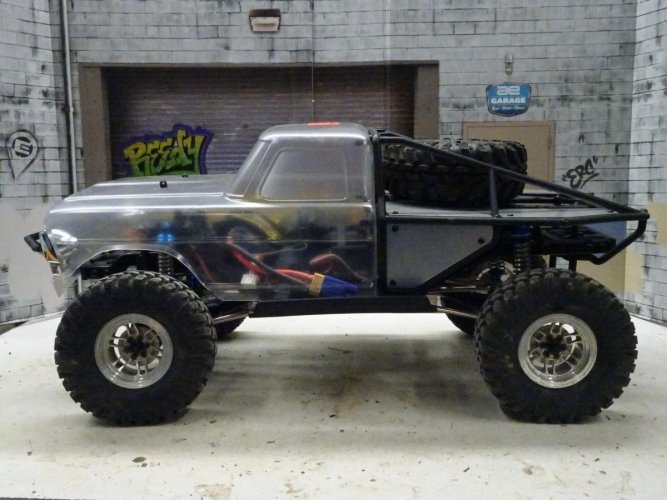

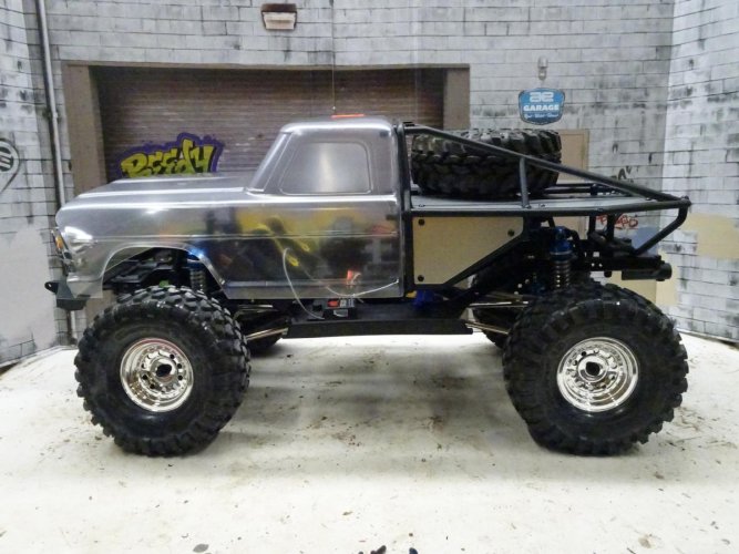

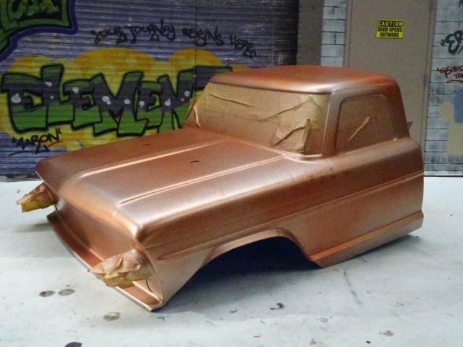

With the chassis assembled and electronics installed, it was time to sort out the body. I started with a blank mind and a blank body, and this is what I saw:
From this, I drew the following inferences:
  • The body sat too high with the truggy cage's lower cross member sitting on top of the rear chassis rails (as evidenced by the sizable gap between the rocker panel and sliders.
  • Even at the elevated height, there wasn't going to be enough room to run 4.6" tires without significant trimming of the front fenders.
  • The front bumper from the 10.2 XJ protruded more than I'd like given the body's delightfully short front overhang.
After testing out a few combinations, I settled on this:
1.9 Braven Berserkers (4.35" OD) mounted to an extra set of GCM Stealth beadlocks that I had lying around, truggy cage's lower cross member captured underneath the chassis rails and a bit of trimming (mostly to the front fenders and underneath the grill), and leftover plastic bumper from TF2 kit trimmed slightly (remembering the budget).
Here are a few pictures of the rear mount that I created:
And yes, the mount hinges allowing the entire body to be flipped open for easy access underneath:

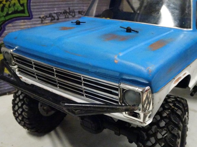

With that out of the way, it was time for painting. Against my nature, I forced myself to finish the paint job in a single weekend (one in which we took the kids for their first off-road trail bike ride, I installed a receiver hitch and 4-bike rack on the minivan, I installed more wall organization stuff in the new garage, shot some video with the new TRX-4 G 500 4x4 Squared, plus the usual family weekend activities). Which is to say I wouldn't have much time.
Unfortunately, I got off to a bad start with a perfectly cruddy job of painting inside the Lexan:
Followed by an equally cruddy job outside the Lexan:
Since that didn't go too well, I tried covering it all up with some traditional Ford colors:
But I messed that up also:
From this, I've deduced that I'm no good at painting. In case you couldn't deduce the entire chain of events leading to this poor result, here are the most pertinent details:
  • 2 different Tamiya rattle can polycarbonate copper-like colors sprayed/splurted unevenly on the inside of the body, followed by a full coat of Tamiya polycarbonate silver while the coppery colors were still wet.
  • Full coat of Tamiya light blue paint (the TS variety, not the PS variety) inside the cab after the silver dried.
  • Full coat of VHT clear gloss wheel paint (from auto parts store) after the blue dried for protection.
  • Full coat of Tamiya silver polycarbonate paint on the outside of the cab.
  • Same 2 copper-like colors sprayed/splurted unevenly after the silver dried.
  • Tamiya white polycarbonate paint over lower portion of body (with upper portion masked off).
  • 1 coat of VHT matte clear wheel paint (from auto parts store) to seal and protect the white while painting the blue.
  • Tamiya light blue paint (TS variety again) over top portion of body with lower portion masked off.
  • Wet sand with varying grits to reveal rust/silvery metal at different layers.
  • 1 coat of VHT matte clear to seal everything.
  • Dry brush selected areas with lighter blue Citadel acrylic paint to provide layered faded look.
  • 1 full coat of VHT matte clear to seal again.
  • Splotchy application of VHT gloss clear to provide uneven sheen.
  • 2mm chrome marker to create windshield and rear mirror surrounds, and body trim.
  • Black permanent marker for door window gaskets.
I also had time to get it out to run a bit in the yard. My initial impressions were favorable. The low slung stance helps with stability, and the Berserkers have excellent grip. But after driving it some more, I'm not as impressed. I'm finding a surprising amount of torque twist, and the large flat spots on the diff covers can get hung up on rocks and roots. It's still quite capable and represents good value for its price, but in stock form, I wouldn't put it on the same level as the better platforms in this segment. I'll work on putting together some video footage in the next couple of weeks. That's it for now.
The Ford and Chevy Ascenders look much better with a smaller tire OD, so those are a better choice...
Paint doesn't look half bad!
Lovin' that hinge mount... "thumbsup"
SSD needs to release ramped diff covers, ASAP!
I honestly like the paint job. Although you think that you might have messed up the copper and silver underneath, once you sanded the blue on top to reveal the"rust", it gives it that old weathered look which is exactly what you want with that body. I guess you could call it a happy accident.
Sent from my LM-G710VM using Tapatalk
