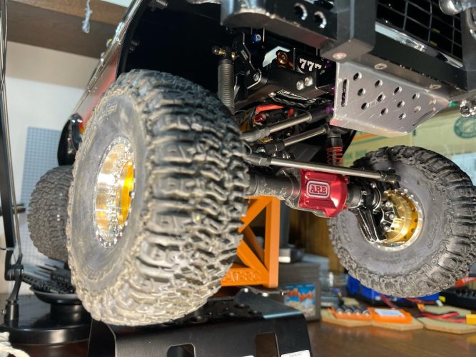

Most of my rigs have 4WS some are on axle some on chassis and some combo!!! I have a Spektrum DX5 Pro which is great for 4WS but I also use the Flysky GT5 and its a breeze to switch the 4WS position quick from front or rear steer to crab steering and full opposite steering and they work really easy with the flyskyGT5 My favorite combo for 4WS is chassis mounted servo front and rear axle mounted servo works great and either I run an overdrive in the front axle or a under drive in the rear axle!!! BUZZZZZZ......

Skeptical Honeyman108. Trying to picture the GT5 steering front & back axles independently, AND also using the throttle.
