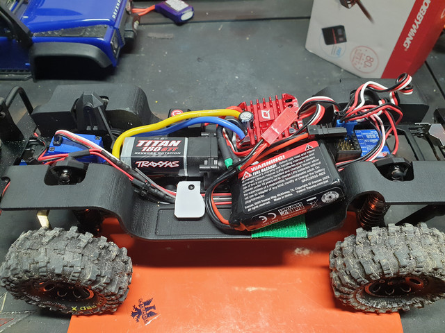

Installed the inner guards which gave me more space so I changed over to a 1080 and GT5 receiver.
Heaps quieter, no more whining.
Also added the brass diff covers and c-hubs then completed the bearing upgrade so no more mud :( (I hate stripping and cleaning after).
Great pictures! Can you post a pic of 1080 fitted? I've got one laying around ...
Sent from my LG-V521 using Tapatalk
I haven't changed the plug on the traxxas battery yet, I did make an adapter but yesterday I just ran a 300mah.
I used a bit of styrene like material to create a flush surface for some doublesided tape for the ESC.
Most won't need to do this as you can just stand the ESC on it's side closer to the front wheel but the interior interferes with that in my case
I am not yet finished, likely will make a small platform between the frame rails that holds the esc centered and run two smaller batteries if I need run time (I hardly ever get more than an hour each day to go and crawl).
