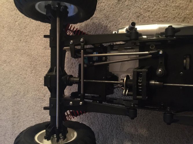

I put 4 spider gears in my Mad Force 2.0 (nitro) and 50,000 in the diffs. Feels perfect. Tightened the diffs up a lot but they still break free when they need to.
I would also suggest making a drag link to eliminate the slop in the steering. I replaced ALL the stock links with VP titanium links. No slop or wiggle what so ever.
Thanks I took the front diff out and mixed a little 10wt shock oil in the diff now it spins a little better than in the video above as it was to stiff.
ware did you get the rods and what ones?
also how much did they run you?
