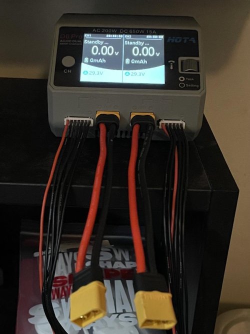

That's the charger I use. It's ****in' awesome. Good choice.
If your batteries use XT60 plugs, then you don't need anything else. Otherwise you need adapters... female xt60 to whatever male plug matches your batteries. I use xt60's, but I made extensions just to make it easier to plug stuff in (and not wear out the plugs on the charger).

+1 [emoji1417] for the battery extension idea. I can save my charger connectors from additional wear and tear
