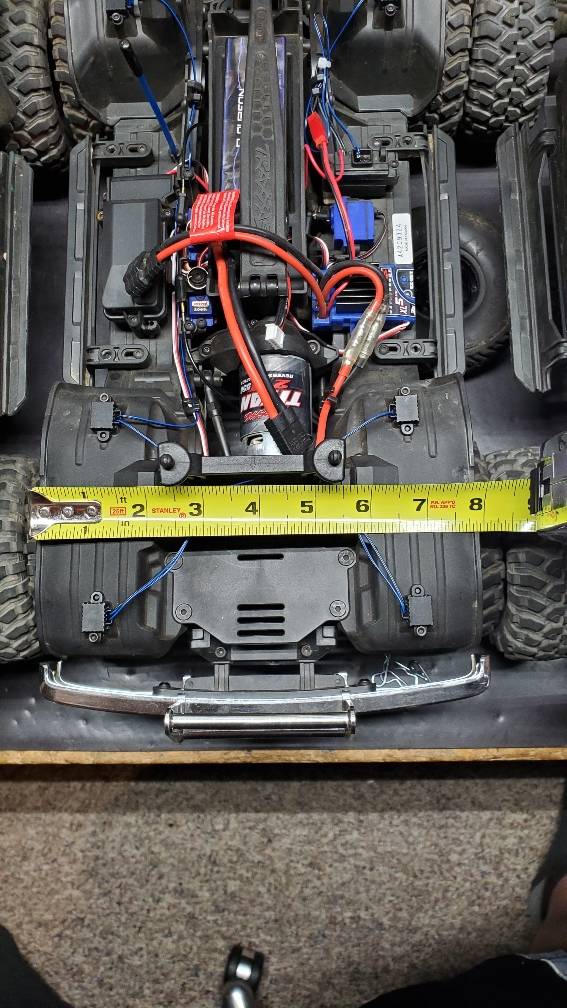

These chassis are all the same width. The difference is only the width of the inner fenders.
The sport you have uses Traxxas part number 8080 (narrow fender set). The sport body will drop right over these with room to spare. Since you mentioned you run in mud/water, you'll want a better fit between the inner fenders and the body, also get Traxxas part 8081...these are thick rubber extenders that screw onto the narrow inner fenders. They seal up the wheel wells much better. You will have to trim them to fit the sport body as they're oversized and not made for a specific body.

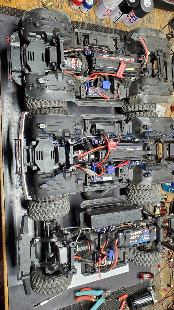

Here are the fronts of all 3 sport with narrow fenders and extensions then bronco the land rover

Bronco body fits on sport fenders just fine.
Rear fenders are the same width

Just a quick update...
Since I bought the wrong (Defender) fenders, I decided to try to "make them work" until buying a proper set. I cut a mounting hole to hold them with the upper shock bolt, and cut holes for zip ties to hold to the frame. I have some pics below.
They're definitely not perfect, but they're on there solidly and definitely doing more than if they weren't there.
