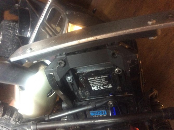

If you want to just bolt up...this is 1/8 x1” aluminum might find at Ace hardware or others. Sturdy enough but if you want slight bends...you can. Bolts down low to keep bumper as high as possible. Grind bumper mounts to go in further. Or flip mounts if trx-4. Hobby shop should have long 3mm bolts. Buff aluminum with Mother’s polish or turtle wax rubbing compound. Or paint flat black and touch up often.

Trx-4 Bronco front bumper mount. Grind off anything you do not need. I can take a pic of the body off. There is a lot to learn from this site. I am always reading new threads on how to upgrade these rigs.
Remove the black plastic insert behind the chrome bronco bumper and use that as a very low profile bumper.

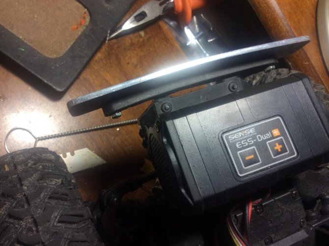

The front mount that the bumper slides into is flipped so it curves up. A Bronco front bumper mount was ground down to 1/4 “ facing the front. The back side with the two channels was grinded also. The two Channels were further grinded so they are square soon as they protrude from the back. The bumper mounting holes are low so the bumper is almost higher than the front wheels.

Jeff6x6, what the heck is that "sense" thing installed in front of your servo?
It is not for everybody. I love it. It holds two sounds. I am looking in to this right now. The yellow wire lets you use a horn. Of course I need to set up the Dixie horn. You have to have an extra channel. I am thinking of locking in the front. Tye rap the cable. Thus freeing up a space for the yellow wire to be controlled.

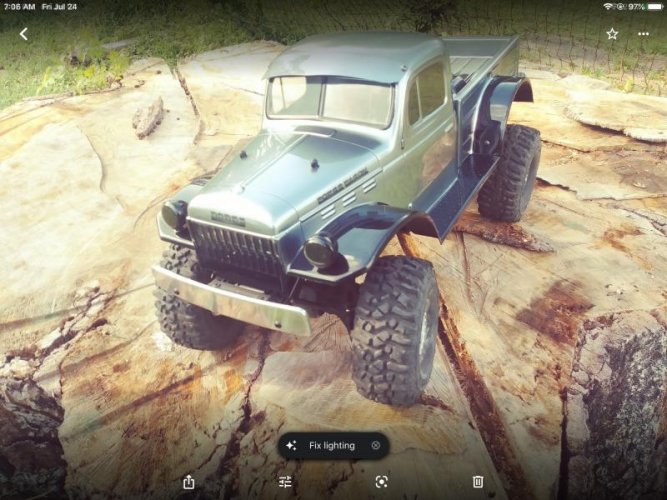

Ok guys, after a couple hours I've come up with this!
I'm quite happy with it, but i think it needs some fog light holes drilled in it or something just to break it up a bit so it doesn't look like a big bar stuck on the front of my truck. Any thoughts on what i should do are appreciated!
