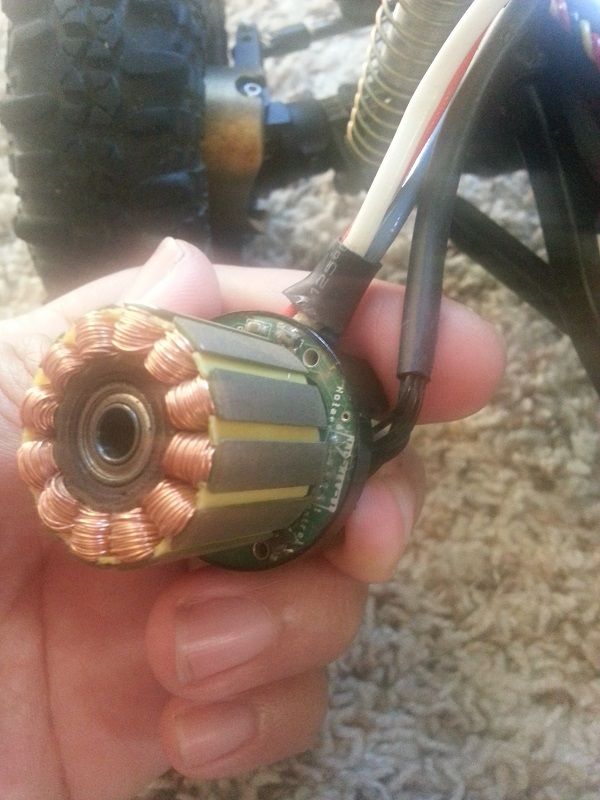

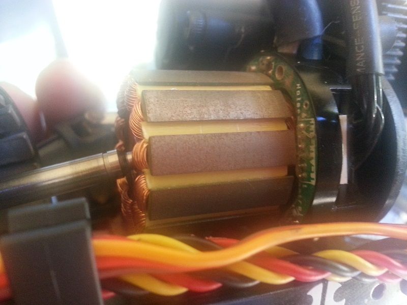

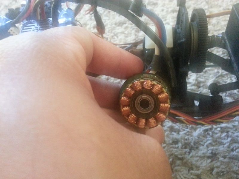

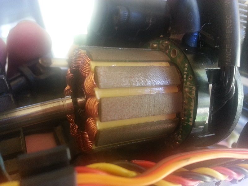

Since it only happens when there is an increase in resistance on the motor in reverse and I've tried a different ESC with no luck, I'm leaning towards that there's an issue with the sensor board on the motor.
