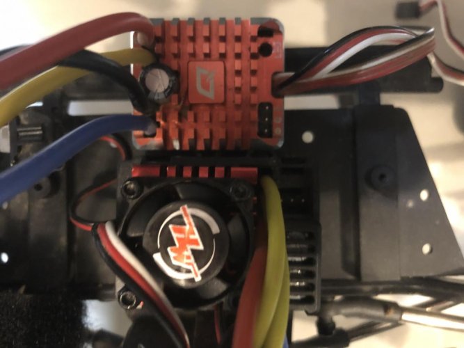

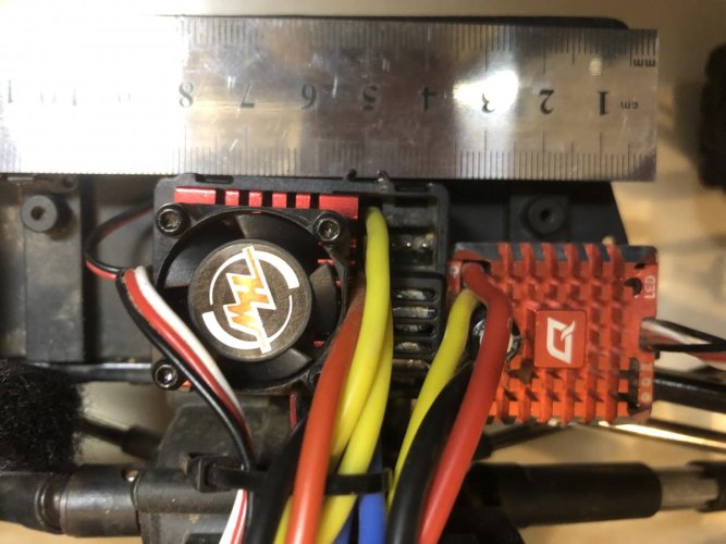

Is this taking the place of the 1080 as the "go to" brushed ESC now? Does anyone have a photo of them side by side for a size comparison? The 1080 is perfect in my SCX10ii and just wondering how much bigger it is?
Bigger but not big, IMO. I don’t really have enough experience to comment on your other thoughts. This one runs a 13T Crawlmaster Sport on 4S regularly, no problem and stays really cool, like ambient temperature cool as far as I can report, on stock gearing.

Great, thanks for that "thumbsup"
