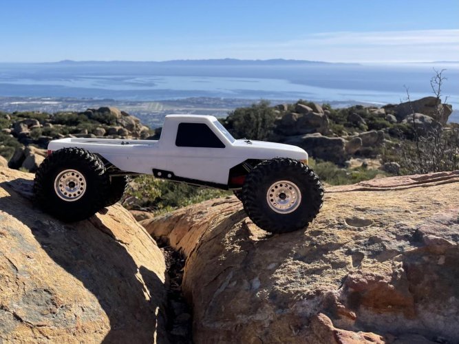

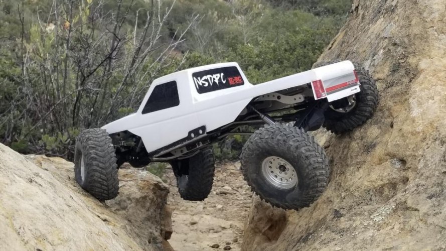

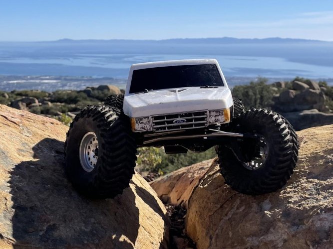

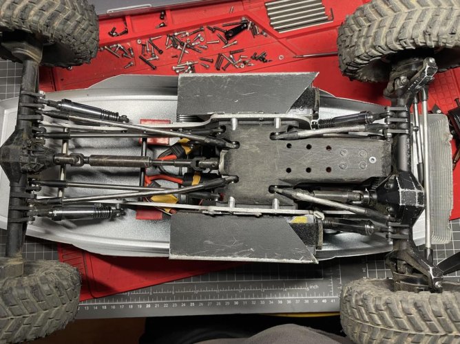

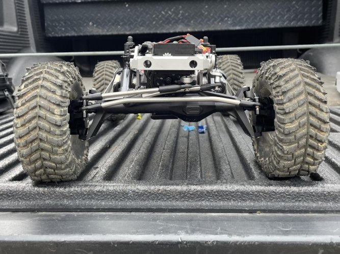

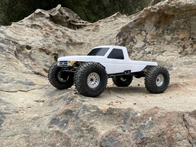

DRED805
Brazin HiLow Chassis
VFD w/Dig
3 Brothers 1600kv Acis Motor
48/13 Spur/Pinion (to clear the diff housing)
VP Capra Front Axle (15/20 OD portal gears)
Supershafty Aluminum Knuckles
Stock Capra Rear Axle (VP internals, besides HR 13/22 OD portal gears)
Custom Short Front Links (panhard bars?)
Shortened Incision Front Driveshaft
Hardcore RC High Clearance 12.8" Rear Links (with long 5525 rod ends)
SSD Rear Driveshaft (for long wheelbase TRX4 and SCX10.2 kit trans)
Dravtech Short Shocks (limited to 90mm)
Mamba X ESC (fan/switch removed)
Holmes SHV500 Low Profile Steering Servo (chassis mounted)
NSDRC RS100M Dig Servo
Tattu 850mAh 3s Batteries (x2 in series)
NSDRC 16.8v Limiter (for steering servo)
IERC Aluminum Power Wagon Sliders (modified/moved back to match shortened front)
KNK Body Post Mounts
JConcepts Tucked F250 Body
13.25" Wheelbase
VFD w/Dig
13.25" Wheelbase
