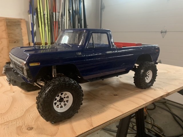

Agreed! I will be using the F-150 body I got from mgputer.
I honestly wish the axles were a bit narrower. Hopefully it will look a little better once the 3D printed fender flares are on.

It is installed and runs pretty good in the house, it will be nice once all the snow is gone and get it outside to see how she handles.
Plenty of power, but she is a noisy little bugger :lmao:
Between all the gear noise and the high pitched noise of the motor/esc, I think every child and dog within a mile radius scatters when she is running
I think I need to take the transmission a t-case apart to re-grease the gears and take a look at the bearings, as well as address some slop in the driveshafts.
