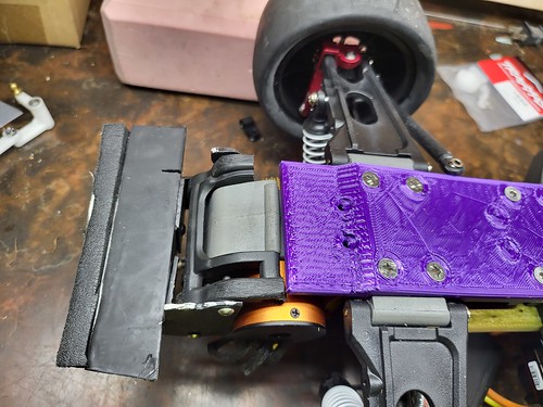

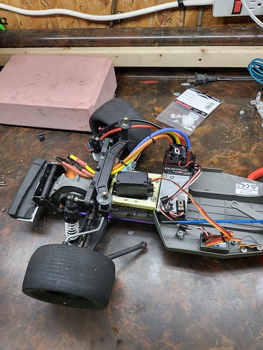

CamoColton, it worked perfectly! I will be using the PLA print as a template to cut these out of carbon as they are pretty weak as of right now but the wheelbase is exactly where I need it to be and the front of the chassis extension lines up exactly with the front bumper mount. On to the pics!
Very nice!
Thank you! I made sure to credit you in the YouTube video as well; can't thank you enough for your help. I've got a slab of carbon fiber ready to be cut and hope to have the final version done this weekend.
