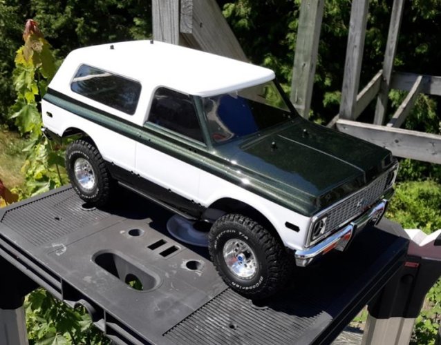

You can use auto paint on lexan also, as long as you spray PS-55 first. This is my TRX4 with the PS-55 and automotive dark olive metallic paint.
