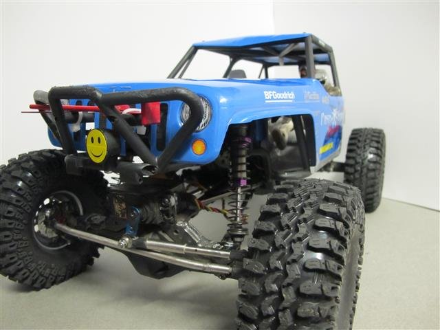

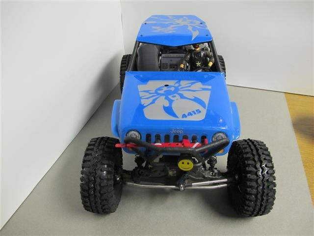

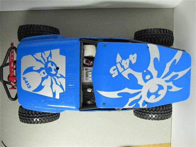

The Wraith axles with the big 1.9's worked ok, but the width is still tough to deal with on obstacles so I decided that narrower axles were needed. I am trying to get Short Change and my new 1.9 ready for the next event on Sept 14th so I had to figure out how to do a quick axle swap.
The answer was to take the rear axle out of Guido. That axle was still an AXR10 axle with Beef Tubes and a nice low, axle truss mounted servo so it would be a good swap.
For the rear I had to steal the rear AX10 axle out of Peanut.
Last night I threw together some front upper links to see how this was all going to work out.
There is still some finalizing of link lengths and link mounts to do but it looks like this is going to work out really good and go together with minimal effort. That's good because I need to spend the time getting my 1.9 running since I stole parts off every other crawler I have to get this going. :shock:
I will show some more detail as I finalize everything but here's how Short Change looks at the moment.
