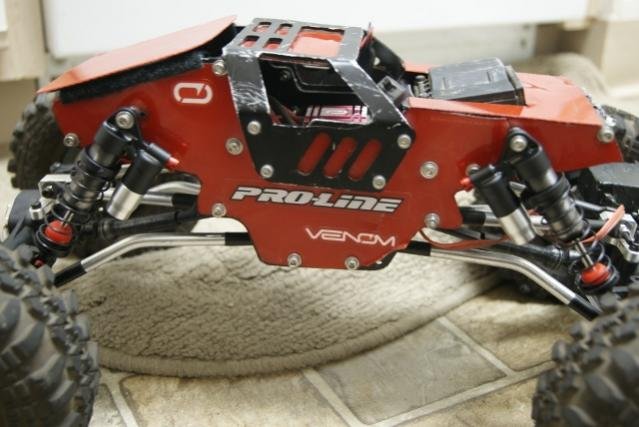

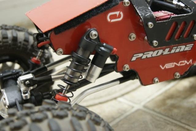

So after a few hours of putting these shocks together, they came out looking rather good. Much better than the ts01 shocks, now I just have to take it out on a test drive.
