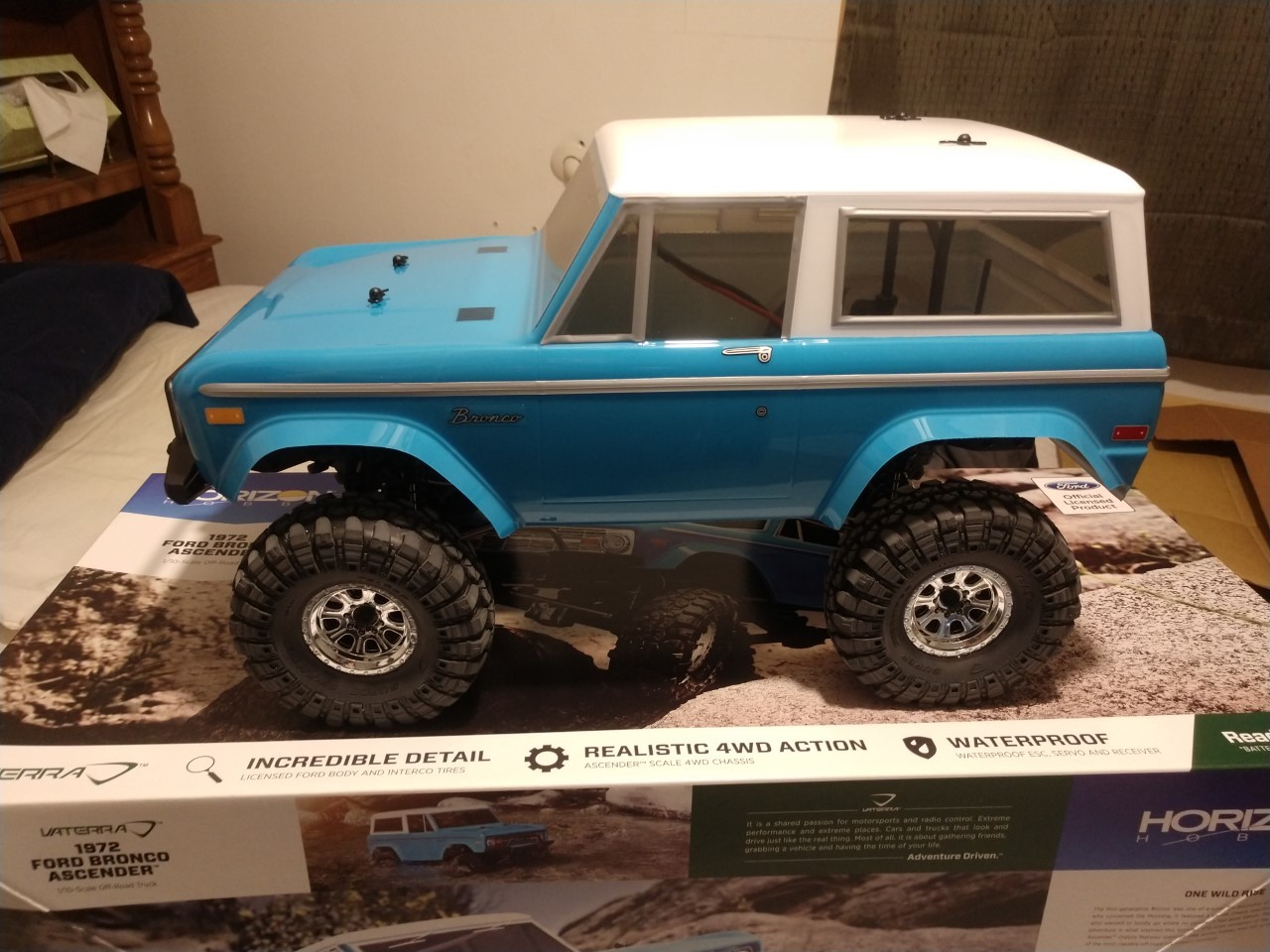

Well I've been MIA since like 06' after my "The Tubicon" Clod axle build. Took some time off for work and R/C oval racing.
Sold all my oval stuff and purchased a Ascender Bronco. Looking forward to some scale comps.
Been reading your guy's builds and they are inspiring.
Had a little time tonight and found this video.
https://youtu.be/-NORRDxCuQM
Did these few little tips and made a big difference in how it performed.
Also removed the silver side trim to clean up the look.
Next on the agenda is class 1 tires so I can lower the body some more for a more scale look and pull the diffs and check shimming and clocking of the axles and shock mod.
Thanks to Natedog for his tips
Once I get the body where I want it, I can start making some bumpers.
Welcome back, congrats on your new Ascender Bronco and glad the tips are helpful! Looking forward to the new C1 tires setup too! :)

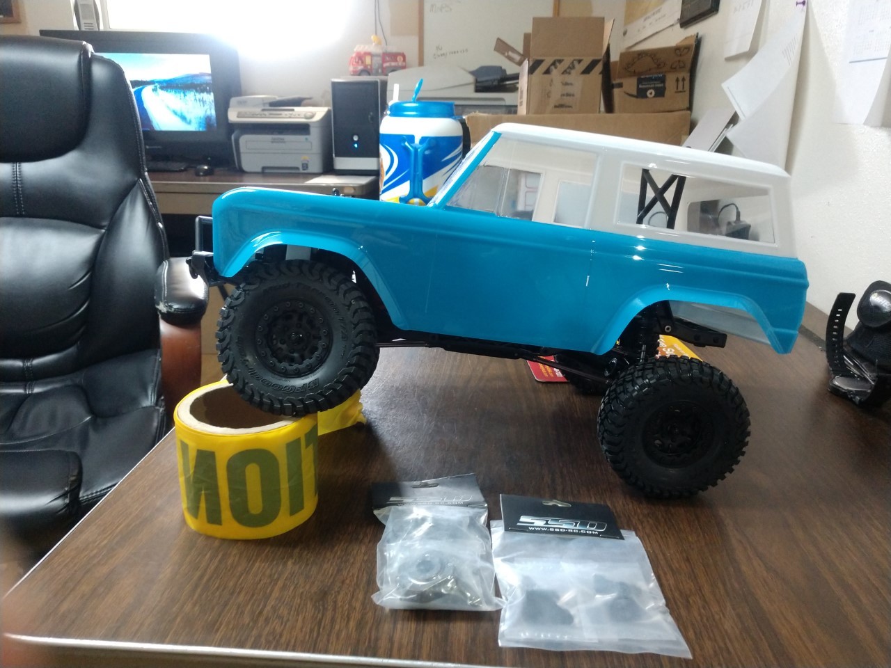

Loving the truck, happy with my truck choice. Liking the look of the Class 1 tires, need to add another hole to each tire. Moved electronics and battery. Happy with the improvement so far. Got some SSD parts in today, hoping to get these on so I can test some more.

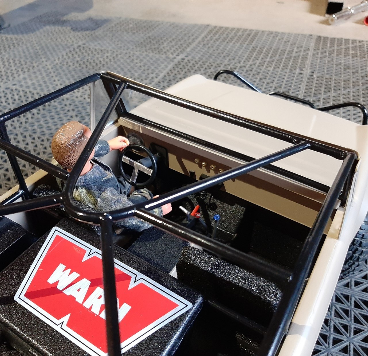

Sorry I haven't posted in while. Between a promotion at work and having a crazy busy fire season last year, I didn't get to do much. I bought some upgrade parts and they stayed in the box till last week.

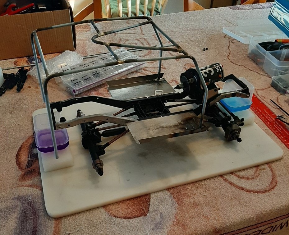

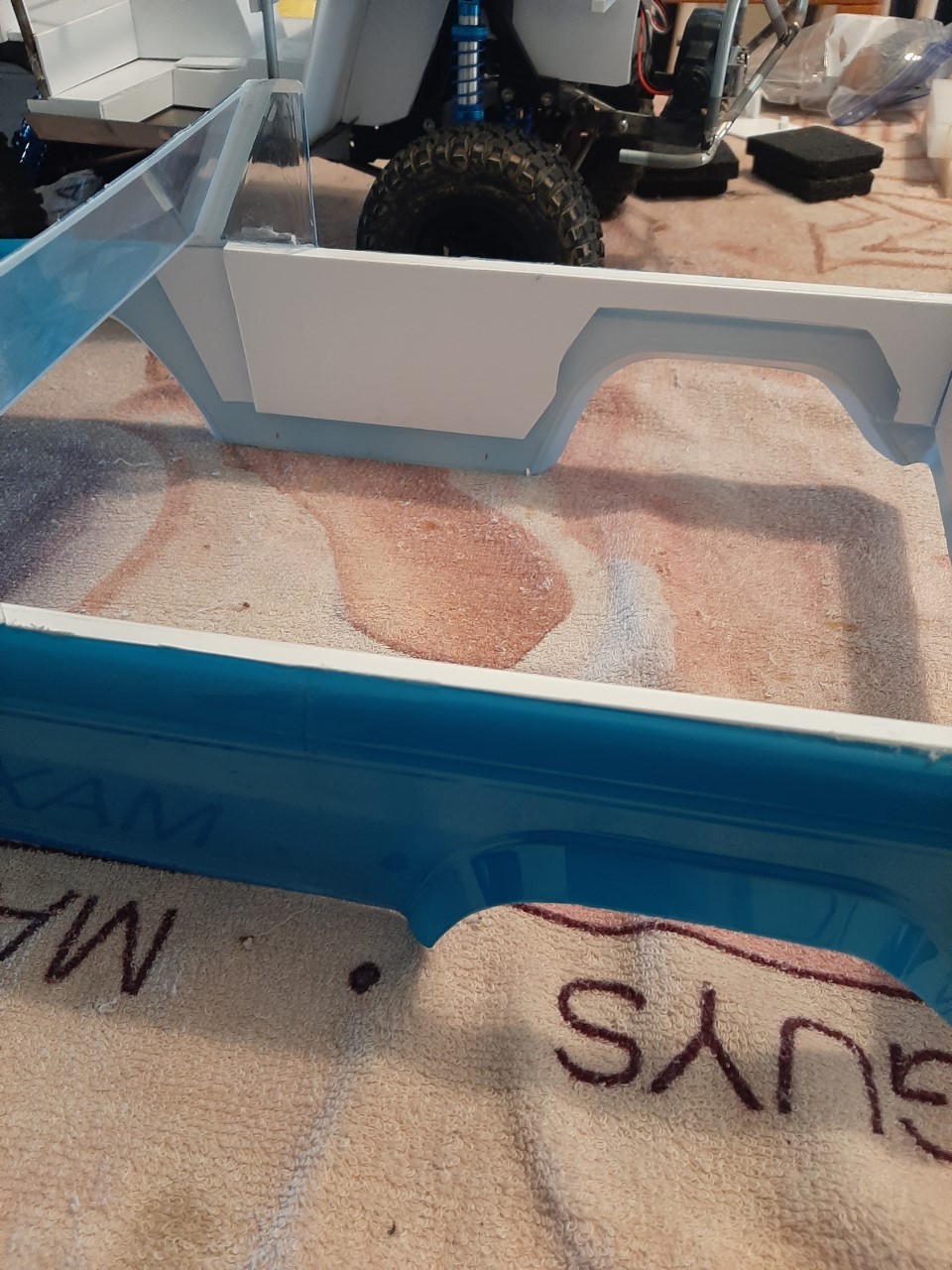

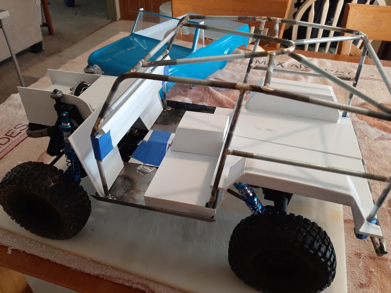

I wanted something different from the rest of the Vaterra Broncos, so off came the roof.

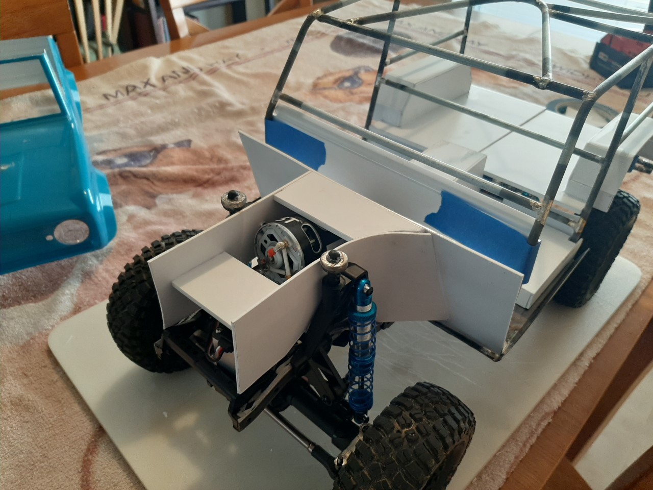

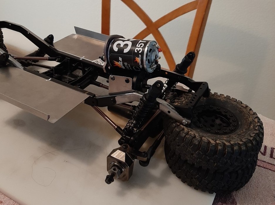

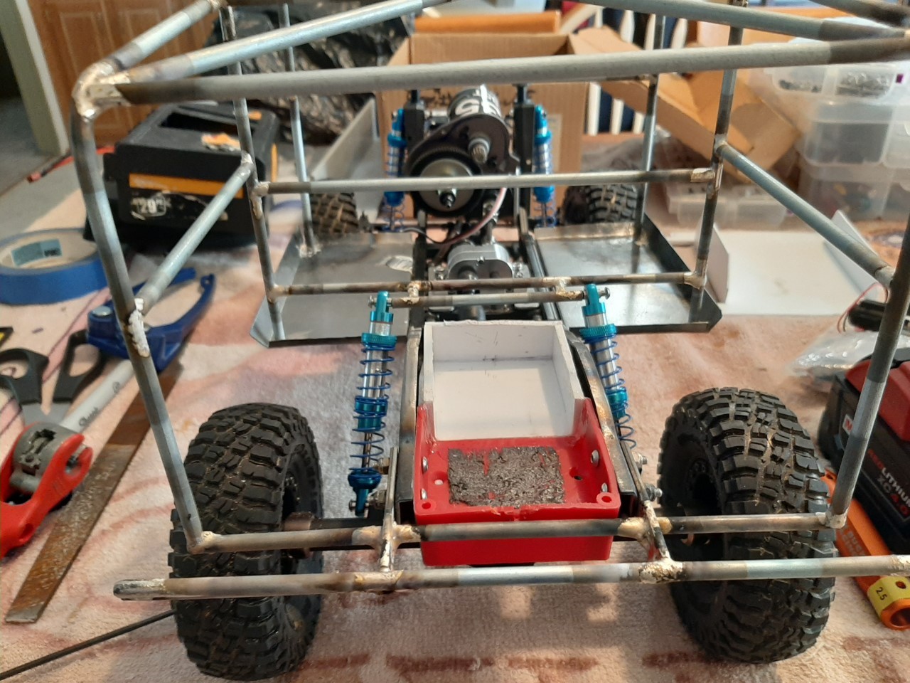

I built a bracket to move the motor forward.

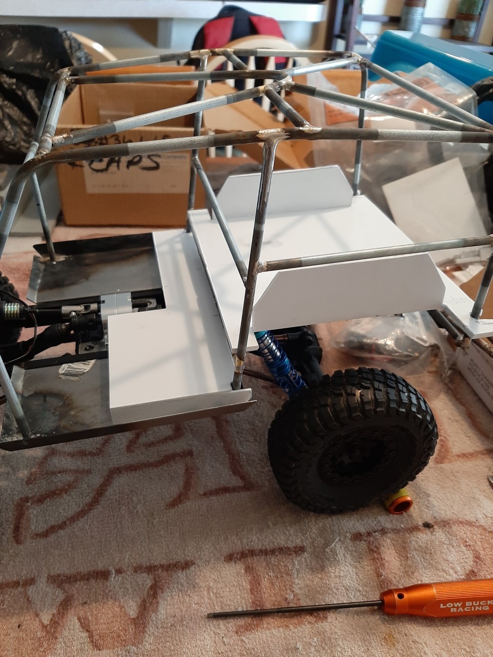

I got my slider/ floor pans started

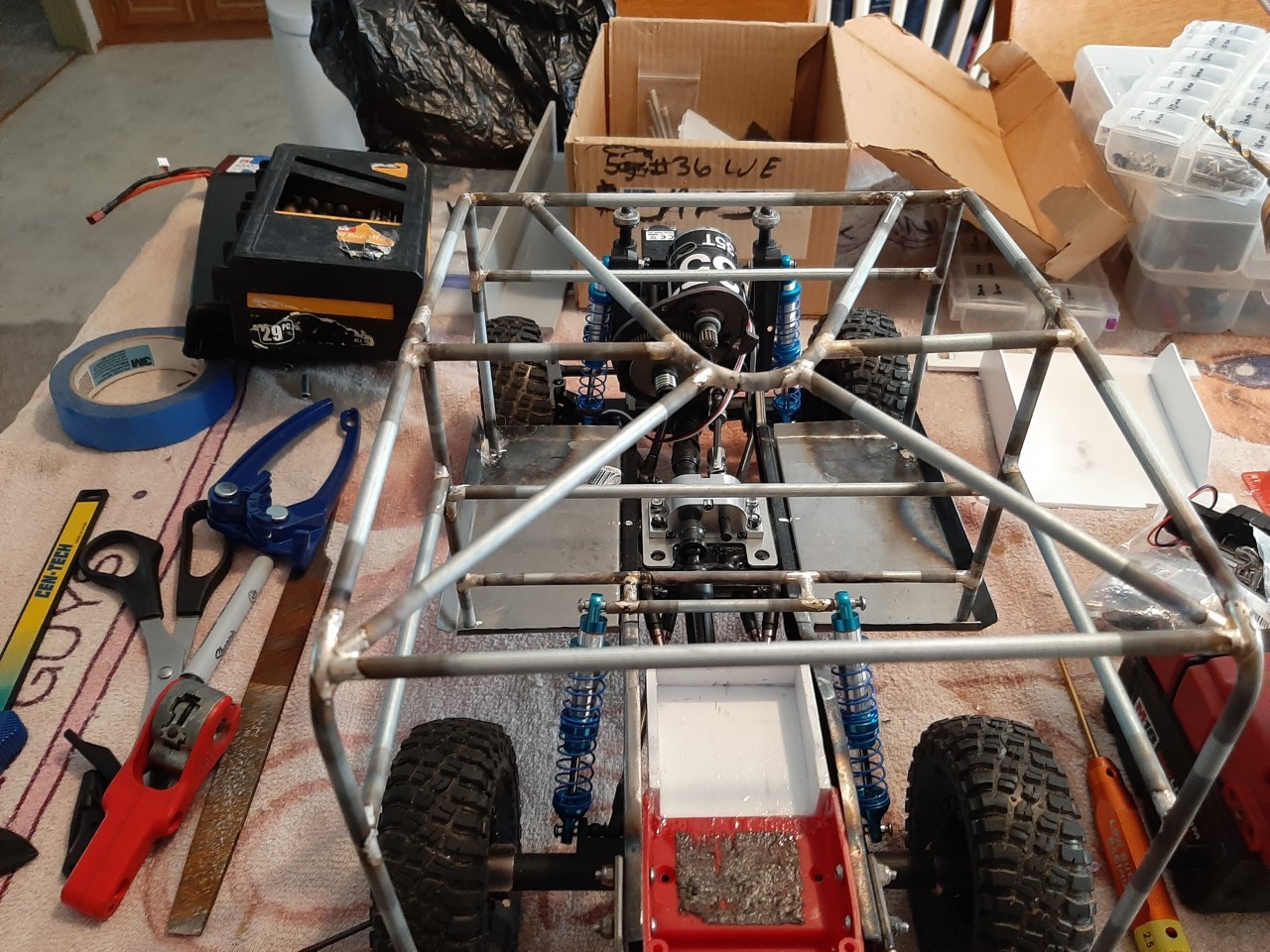

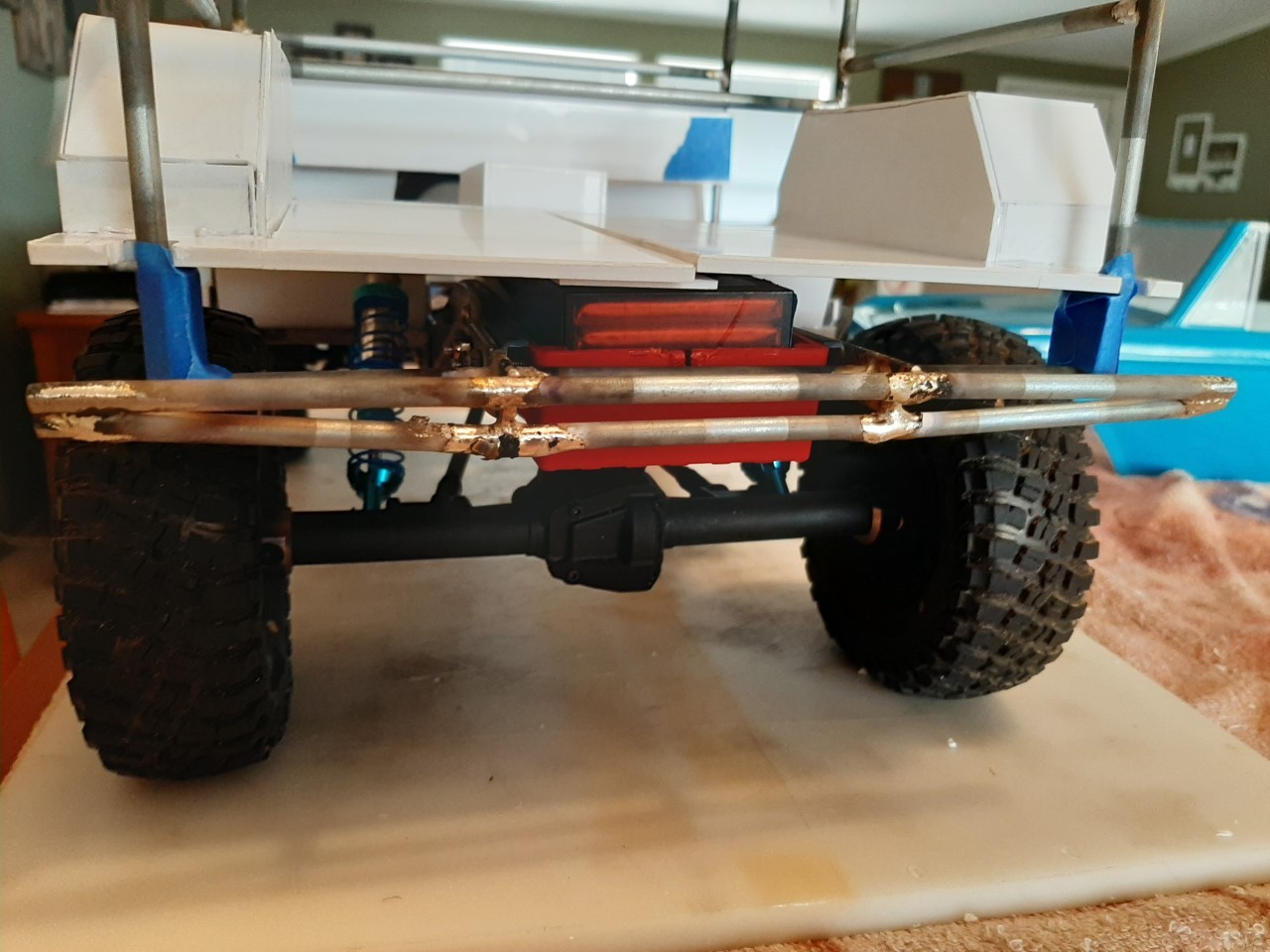

Got some cage work started.

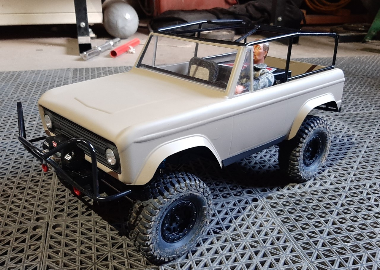

Finally got to get back on this thing. Finished up the cage, rear bumper, and started on the interior.
Very nice. Interested in seeing how you finish up the interior and attach it and the body to keep everything together but also be able to take it apart to remove battery etc. I started on a blazer build that I chopped the rear roof off like the factory trucks, made a cage but stalled on the interior because of trying to figure out a way to mount body and interior so it looked scale but also was functional to take apart and work on the chassis if needed.
Ben

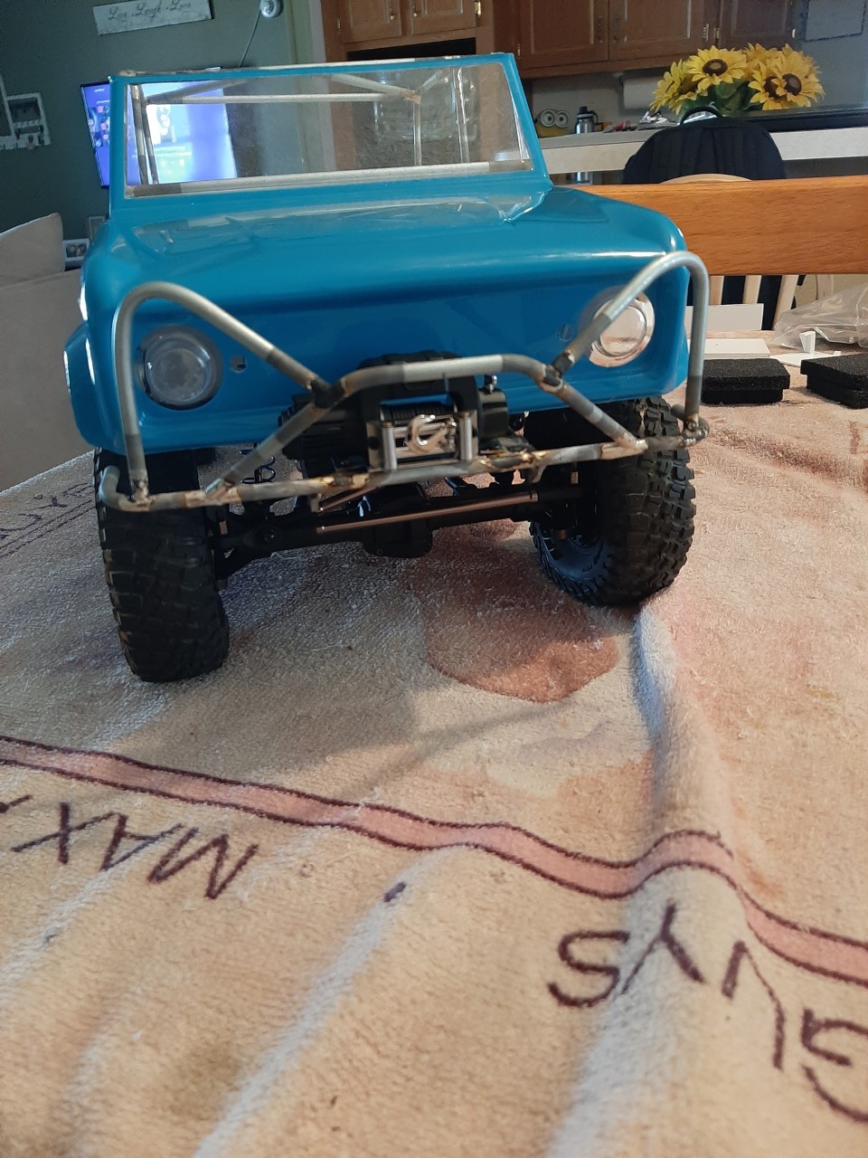

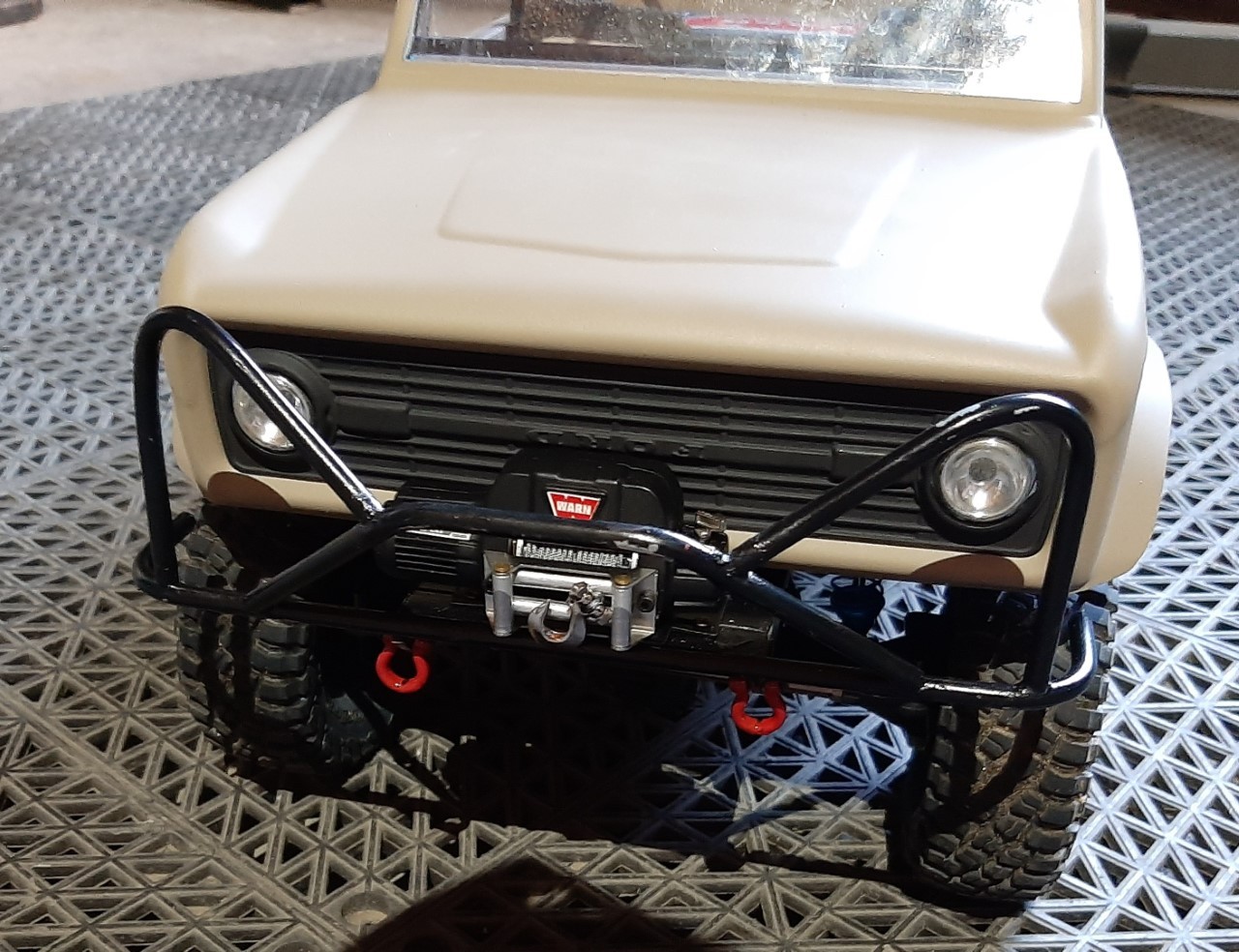

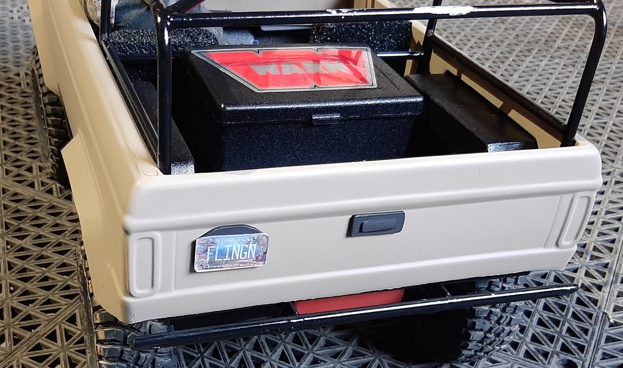

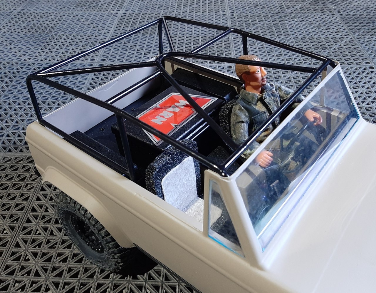

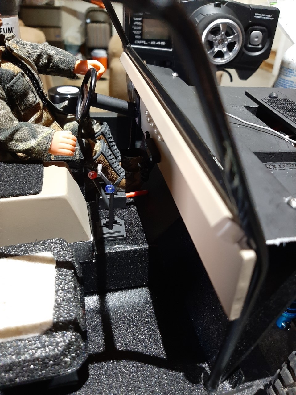

Finished up the interior structure. Now start body working and detailing it. Finished up the last of the metal work with the front bumper.
Made some progress this weekend. Working on some of the details and waiting for my lights. Need to repaint the cage and bumper(cheap paint not sticking)
Very nice looking build![emoji106]
Styrene and cage work looks great!
