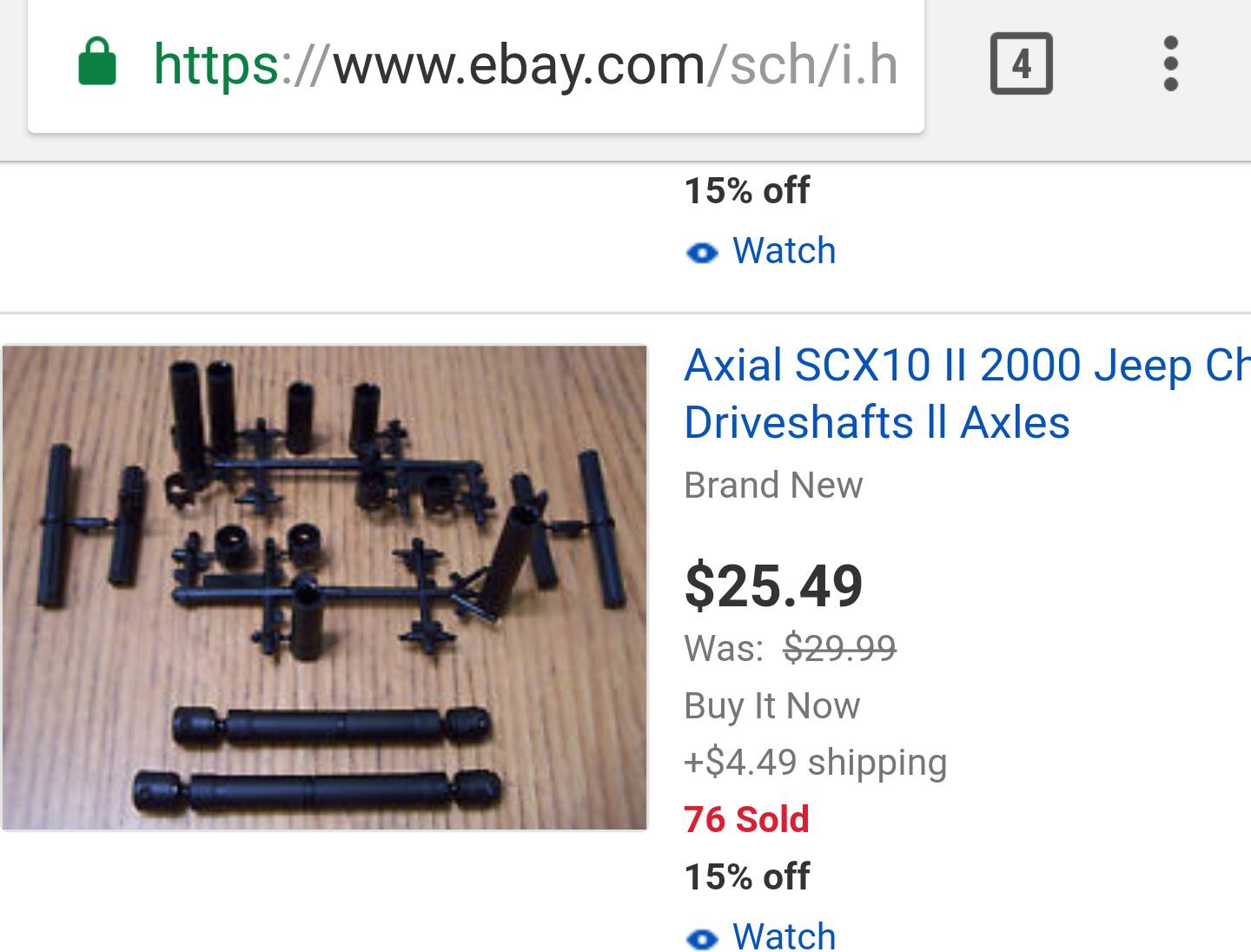

I like the Axial wb8 set myself; be sure and get the couplers, not just the plastic replacement parts. Should run ya about $30 for a full set.
If you wanna go cheap then Traxxas makes some expendable driveshafts; tra1953 is the part number and here's more info:
http://www.rccrawler.com/forum/axial-scx-10/384869-scx10-drive-shafts.html
Doesn't look like they include couplers but maybe the stock Gen7 couplers could be used, unless drilling them out destroyed them.
