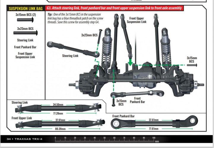

I thought the same thing but after looking at others pictures last night mine seems to be set on the same panhard mount hole and the rod end flipped the same way. This made me wonder if I had something else wrong. The panhard rod end hole will not align with the upper mount hole either at least without some trimming I've already tried.

So I did flip the panhard rod over 180 degrees so that the angle of the rod end is opposite (like King said) and it did help (probably only 1/8" now) but is still hitting and limiting my travel compared to the right side. Does anyone else's hit their diff housing? If I can't figure anything else out I will try to make the upper mount hole align on the panhard upper mount.

Mine is set up the same as yours, but it doesnt touch in any position. Idk if it bein a 6x6 makes a difference, it shouldnt. Have u tried flippin the panhard from end to end? Put the offset end on the axle n the straight end in the panhard mount? I believe, in one of my other trx builds, i had to do that because it hit the axle. By swappin ends, it will put the chassis side where u should be able to use the upper hole, n itll raise it enuf to clear
The last 2 pics are of a custom build im workin on, but gives u an idea of wat im talkin about. At full compression, the panhard side just starts to touch. But otherwise, it clears everything else
