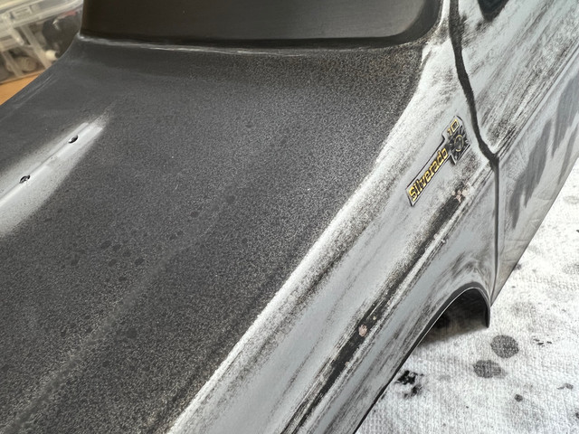

11. Carefully wet sand everything with 600 grit sand paper, removing most of the acrylic black and some of the brown. Here you can see the fender has been sanded but the hood hasn't yet:
Although it's definitely not on Danny's level, I'm reasonably happy with the effect so far. But I do feel like I overcomplicated things. Instead of screwing around with the acrylic paints and the Krylon Matte Clear, next time I want to try painting everything on the outside using only Tamiya TS paints. More expensive but probably worth it in terms of time saved and the end result.
