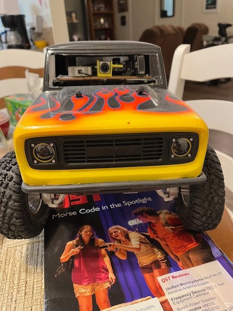

I have a camera on my Ultra with a servo on the camera tied to my steering by way of a program mix. I have DJI video Tx and goggles and the range is great as well as the image quality. I don't have tracking - I want the camera to follow the steering.Ultra.jpeg

It really isn't a power question - 125mW, which is the legal max for non-ham licensed operators is plenty. I've run as much as a 2W transmitter (KK6GBY) and I didn't see any difference from a 125mW setup. The one pictured above is 125mW and puts out a great image almost completely glitch free. Power is really for distance but I don't do much distance with a crawler. Even in air use, 125mW is more range than I need. There are long-range guys but that's really a different aspect of the hobby. Cost is what it is and it all depends on your priorities. I don't FPV drive often but I'm really happy with my system when I do. Before this system I had pieced together some really low cost systems but I was always left with a want for better image quality. It makes a big difference. I do have to add that if I were asked if it's worth the money to do FPV driving I would say no. The thought of doing it is much more appealing than actually doing it. It's cool for a while and then...
