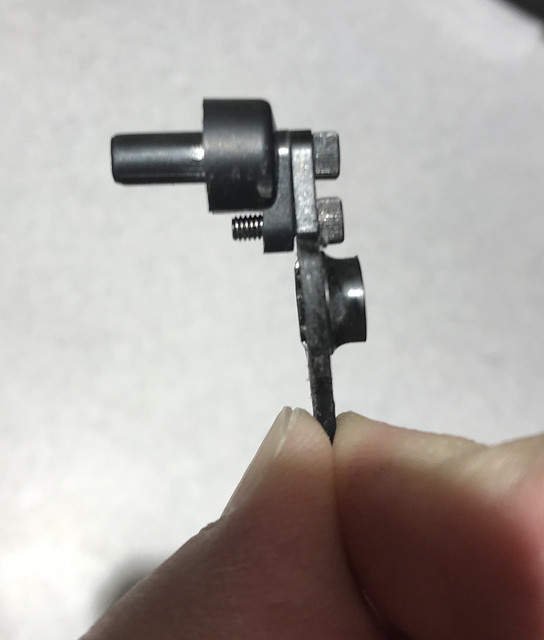

...based on the location of the VR2 knob, it's in the perfect location to INDEPENDENTLY steer the rear with the throttle hand thumb...with an easy mod, this is super comfortable and smooth to operate.
I used an extra piece included with a steering servo I had laying around....liked this because it had perfectly placed holes for drilling and with a little dremel work...about 15min to make
drilled right into the VR2 knob...fit perfect...the VR2 knob pulls out of the controller, no need for disassembly
super comfy ...crawled with this today and it worked awesome!
obviously there are tons of options to modify the VR2 knob to extend it down a bit...it works great and there is a center notch on the knob so its easy to find the center point when steering.
